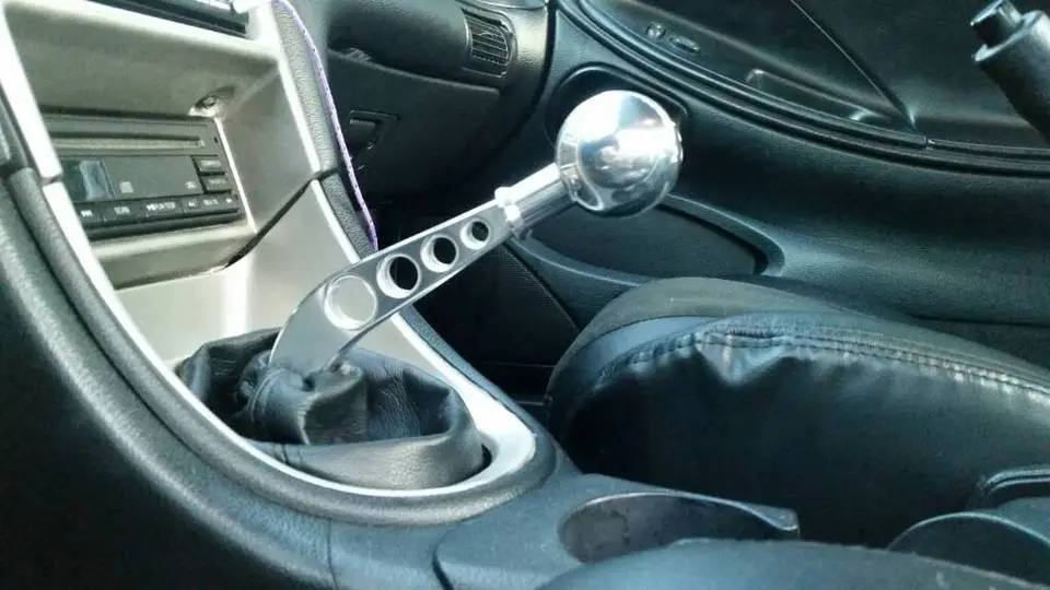

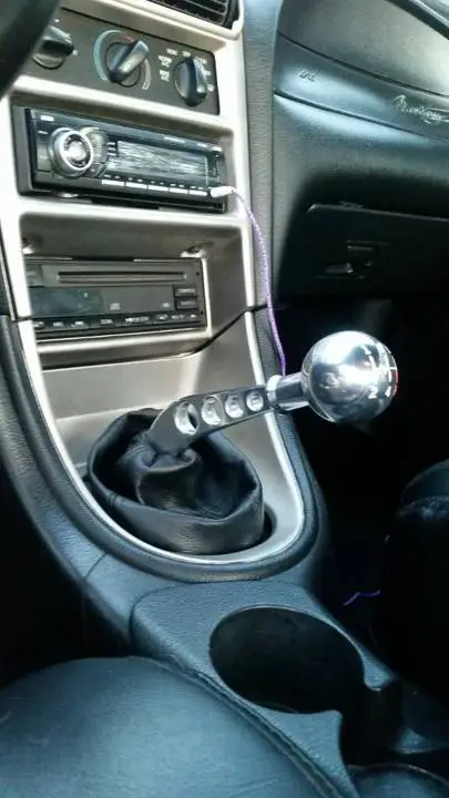

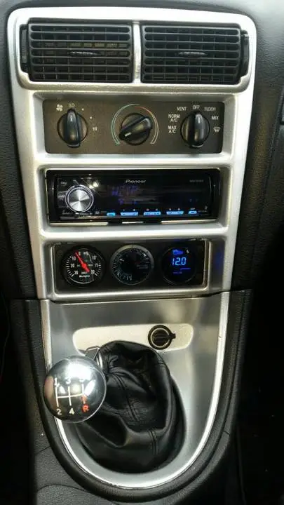

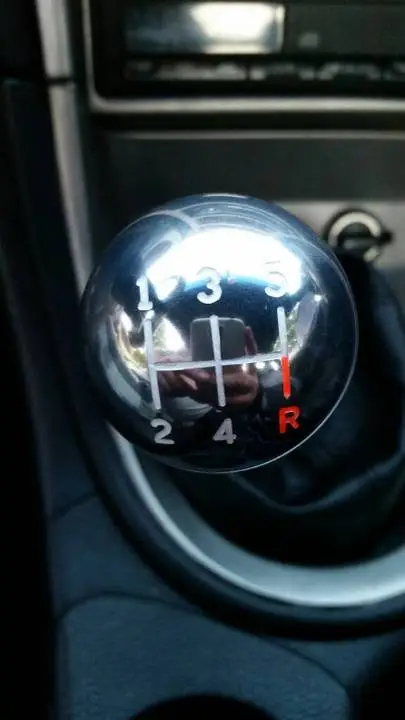

Got my new shifter installed, after polishing the arm and knob, I painted the gear numbers. Then had my gf stitch the boot to fit. So much better than the short throw, knuckles into dash.
Reactions: Kman92

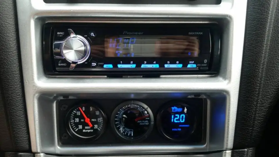

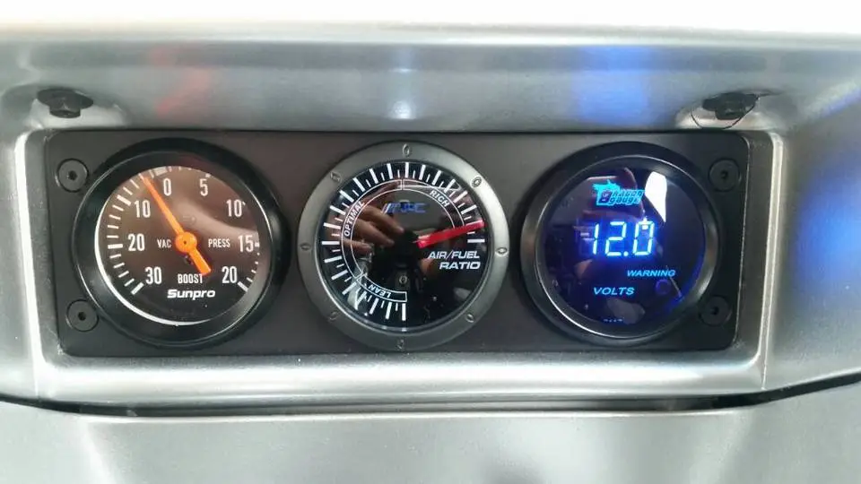

So one day as I was driving the radio came out, which made shifting to third very difficult. The radio was junk, and I wanted something that sounded better. I find a pioneer without cd but bt, and both hookups for iPhone and aux. Got it for Under 100, had to repair one of the radio bevel bolt locations as it was missing. Followed by some paint, and I added gauges. Got a deal on most and had all the stuff to hook then up, I think it came out pretty good. Only kicker I forgot the car doesn't have 02 sensors lol.
Reactions: Kman92
I just picked up a 94 recently,I may copy that gauge panel.
I like the panel too, it's very nicely crafted. The only thing I'd suggest is trying out the location with the gauges right about there under the radio before you commit. I used to have my boost gauge there, but realistically there was no way to watch it safely while under boost. Clock-pod, dash-bezel, and pillar mounts are all options that the aftermarket still supports for our cars where you can actually see the gauges.
