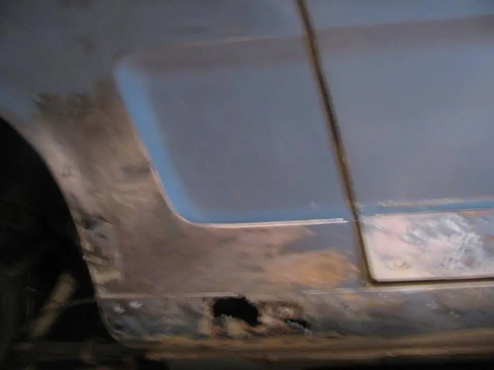

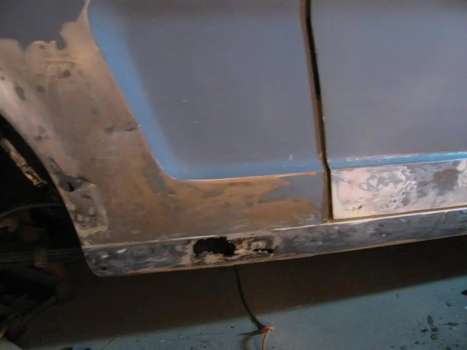

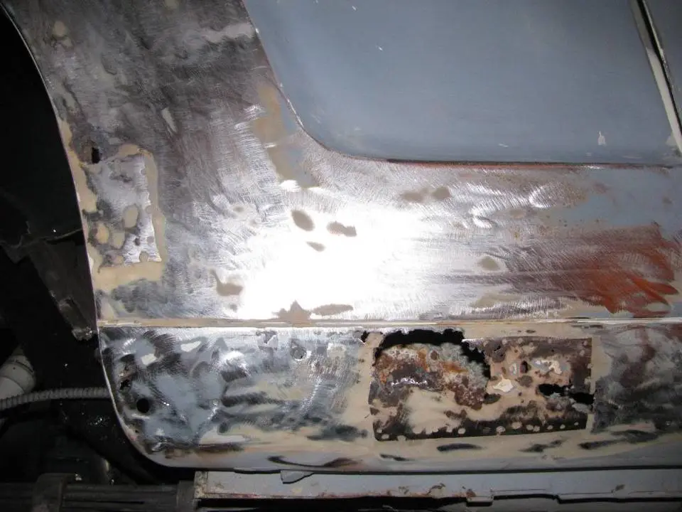

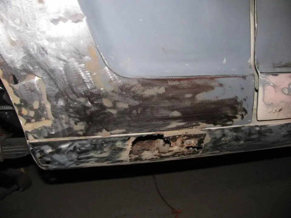

65fastbackresto said:
This was hiding under rocker panel trim piece, the entire area forward of the wheelflare was bondo, theres also a small dent in the mouth of the "gill" where the shelby side scoop was. Not to mention the rust holes...
I`m a little disheartened by this turn of events, but maybe we can get er done.
Man that sucks, at this point I say time to media blast the entire vehicle and see what lurks beneath. Or take it all down to bare metal with some 60 grit sand paper on a random orbital sander.
Well does anyone have any sugestions on how to proceed with this? Gut the rocker? Entire quarterpanel? Partial quarter panel with wheel flare and the forward section?
The rocker panel skin is only $36, but I don`t know what I`m getting into here...
