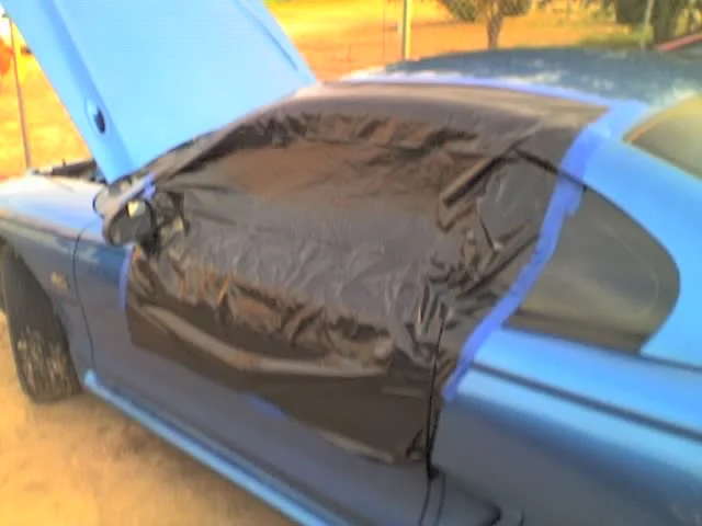

My power window stopped working. It went down but never came back up. I was about 1/2 a mile away from home and it started ****in raining. I got out the car and ran inside for a big ass trash bag and tape. I took the pic w/ my phone after it stopped raining. I thought I would never see the day my Stang would look like this. Pretty dam funny. By the way how would I go about raising the window? I havent looked into it yet but I assume you can just pull it up cuz its not a manual.

Well...if you have enough life in your battery to raise the window, just pop the door panel off and tap on the motor while pushing the switch. I had to do this ONE time in my 2001. Then the motor worked fine and I used it almost everyday for a couple years 'til the car got totalled.
[QUOTE='66 coupe]Well...if you have enough life in your battery to raise the window, just pop the door panel off and tap on the motor while pushing the switch. I had to do this ONE time in my 2001. Then the motor worked fine and I used it almost everyday for a couple years 'til the car got totalled.[/QUOTE]
yup common thing on the newer cars
try banging on the inside door panel while pushing the button
if that dosent work try running power directly to the motor. if it goes up you know theres a problem in the wiring somewhere, if not you know ur motor is toast
