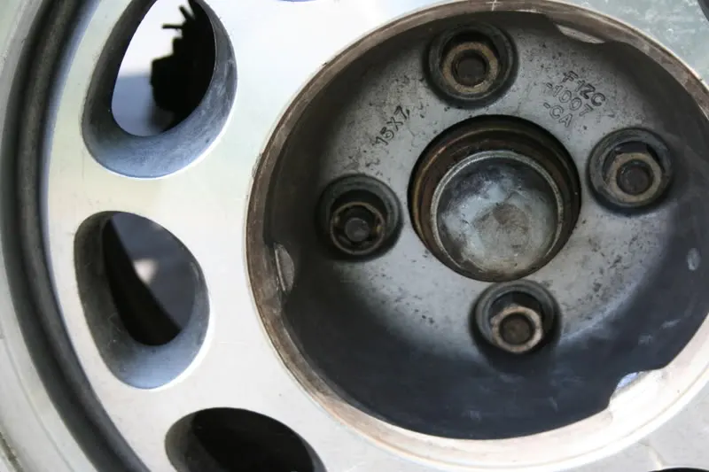

Well like the title says. I was about to remove my front rims to being my 5 lug swap when what do i see? WHEEL LOCKS on every rim. I do not have a key for them. Does anyone have any ideas how i can get these things off without spending hours and hours drilling/grinding/cutting/chiseling them off??? The rims are in perfect shape and i really didn't want to ruin a nice set of rims.
After looking at your pic the socket method may not work but it is probably worth a try. You might also try one of those rounded nut extractors sears sells, it may bite onto that outside.
Good luck!
Knock a socket onto it thats slightly smaller, I mean HAMMER IT ON THERE. Then rip it off with an impact.
This was the method i was going to attempt. I don't want to ruin any of my sockets so i may hit up sears and purchase 4 sockets that i can hammer on and not worry if they get destroyed.
Good luck!
They make them large enough to bite on the outside? I do have access to an impact gun so that should help

I ended up getting a 13/16" 12 point socket and was able to hammer that on.. I only got the front 2 wheels off, i'll worry about the rears when it comes time to do the rears! At least i know it can be done now..
It sucks though because i'm ruining perfectly good sockets but at 6 bucks a socket, and the 2 mins it takes to get them off, its worth it!!
Thanks everyone for the help!:nice:
If Factory Lug Locks you can go to any Ford Service parts department and they will let you use a Lock Socket Kit. It has all the lock codes about 12 sockets and get the locks off. I have taken cars to many dealers and they just held on to my Visa for deposit while I take the locks off.
