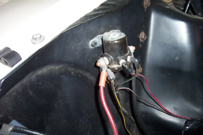

I was in the parking lot of an Oreily's (Thank God) and I was starting the car and it wouldn't start. It would turn over but it would get weaker and weaker and then it would start cranking faster then slower yatta yatta.
Wouldn't start.
tried again same results. Been doing this for about a week.
I opened the hod and the ground wire had gtten so hot that it melted the solenoid and actually detatched from it with the bolt still connected. WTF?
I got a new one put in and everything is fine.
Anyone know what might cause this?

Hot goes from battery to solenoit, and then on the polor popposite of the solenoid, is a wire that goes to the ground (engine)
The thick black wire on the right on the back of the solenoid is the ground.
It melted right through and became detached
Hopefully you realize that the thick black wire (found on the right of your solenoid picture) goes to the starter. The system ground goes from the negative side of the battery to the engine block.
There is just too much current being passed through the solenoid. Of course the old solenoid could have been bad and became toast on its own. . . . . . .
If a new one doesn't correct the problem, I would suspect that you either have a bad starter, the motor is locked up for some reason, or you have a loose connection either at the solonoid, the starter, or the battery to block ground.
If a starter starts dragging (worn bushings allowing the armature to slightly touch the field magnets, particularly when hot, the starter will draw excessive amps resultoiing overheating the cables. If the slow cranking continues, especially after the starter gets to operating temperatures, then may need to replace the starter. The other posts hear regarding bad grounds are also correct.
