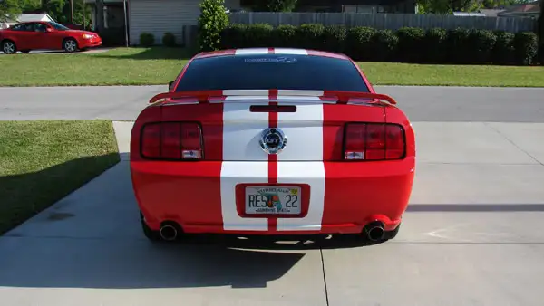

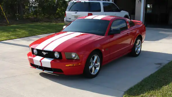

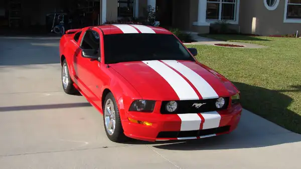

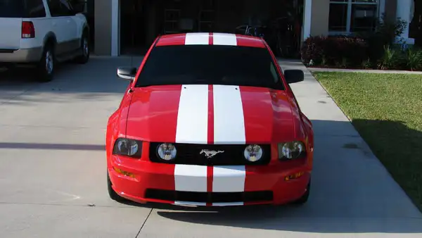

I did it myself, and it was pretty easy. It took all day Friday including a couple of hours for prep (wash, clean w/ alcohol, and tape the center of the car). There are a few small flaws that can't be seen from a few feet away, and some small bubbles that the Florida sun will take care of.
The main pointer is to take your time. I didn't use heat on it either. The rear bumper was pretty challenging around the licence plate area. Anywhere they roll under (like the front and back of the hood, under the wing, etc..) you have to wait for them to dry, then peel off the paper, then very carefully roll the edge under. You have to be very careful with that since they are dry and you only get one shot. The main thing is take your time. And you need another person to help peel the backing off the big pieces (hood, trunk).
