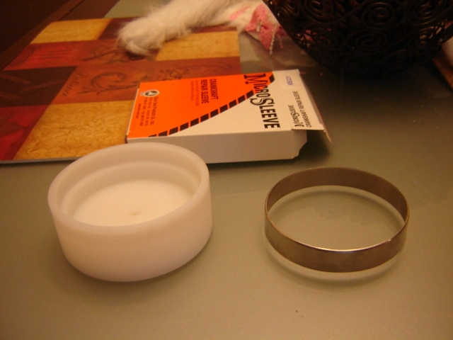

I am in the process of replacing my T5 ,clutch and rear main seal. I have had a rear main seal leak for a long time. I even changed it twice before. This time upon further inspecton i noticed there is a groove in the crank shaft and the seal was torn up as you can see in the pictures.
