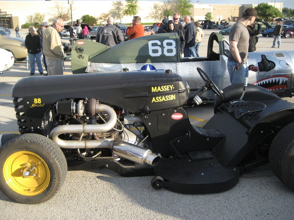

I remain firm in saying that we could have made this work on the lawn mower...

:doh: how much faster could you mow MY lawn then?.......With my chinese turbo, on YOUR lawn mower?
Just sayin....... Next Project???
