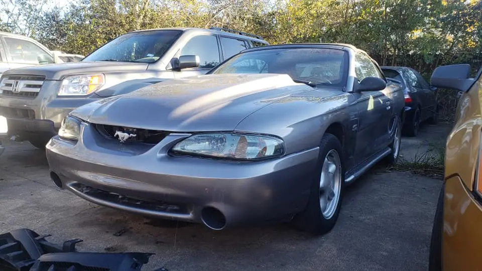

Hi guys, new to the forum here. I have a '95 sn95 GT vert and I'm looking for some direction with it. Not long ago, I had a fender bender and started down a path of repairs which should end tomorrow. Aside from the body work (cowl hood and cobra bumper added at this point) it was determined that my trans lines leaked and I kinda destroyed my AODE driving it to the shop stuck in 2nd gear with low trans fluid. Anyway, after much deliberation and arguing with insurance, I have decided the payout isnt worth a salvage title.
This took a few months to play out. Initial impressions led me to buy a new car right away and thus take my time to deal with the mustang. I have invested quite a bit at this point, roughly 1300 in body work and now 2600 for a BUILT transmission in anticipation of further upgrades. I am committed now to the build and need to make a decision on the direction it will take. Currently, I'm sitting on stock headers and intake, stock heads, CAI, custom x-pipe to two shallow glasspacks that dump below the car, a mild cam, and a BAMA 4-bank eliminator tune for all of that. The trans shop is building the unit to handle 450-500 fwhp (my request) with all the 4r70w goodies and a billet TC with about an 1800-2000 stall. I asked for this because I want this car to stay fun and streetable.
