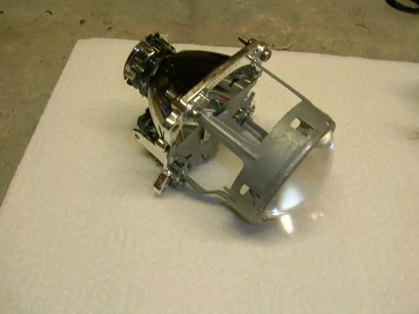

here are some pics of my old setup with the projector retrofitted into stock housings with the flutes sanded down.
low beams
high beams

Those are not projector headlights and you should not just replace your current bulb with and HID bulb/ballast/ignitor. Thats the WRONG way to equipt a car with HID's. All these kits you see on ebay for $300 that replace your stock bulb are a bunch of crap. They cause glare and give a crappy light output compared to a true projector HID setup.
To get the most light output from HID bulbs, you need 4100k or 4300k bulbs. As the color temp increases, the amount of lumens that the bulb outputs is decreased.

fiveohGT: I bought a set of the diamond clear housings. I'll be fiberglassing a pair of BMW e46 projectors into the stock housings. I'll be doing a write-up soon once I get working on it.
