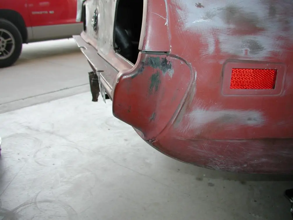

hello all. im new to the forum. i am 16 and am in the process of refurbishing a 1973 Grande and there is a part which i cannot seem to find. its a rubber peice at the back of the quarter pannel that fits inside the bumper. my questions are what is this peice called and where do you suppose i could find it? thanks.

Not sure from the pic, but I think you are talking about the rear bumper guard. Try National Parts Depot, Virginia Classic Mustang,etc... 73 parts are harder to come by but you might get lucky.
Bumper Guard Molding
17C837- (838)
Part Number D3ZZ-17A807-A
Negative. Bumper Guards are just that - Vertical chrome things that IMHO look like crud and theoretically protect the bumper.
If anyone has a 73 shop manual, it will be in there. I only have the 72 which doesn't use this piece. 72 has a rubber piece on the lower front fender behind the bumper (which 73 does not have) which is called a "splash shield". So maybe they call it a "rear splash shield" :shrug:.
I'm pretty sure you're SOL as far as repro's go since this part is only used in 73.
Thanks for the info. Now I have another question. Do you suppose that its possible to use 71 or 72 parts so that I dont need the part I'm having trouble with? If so what peices would I need to do the swap?
I believe the only thing you have to do is replace your 73 bumper mounting brackets with 71-72 brackets.
Save or sell the 73 brackets as they are not available as repro's.
Naturally, you'll have to weld the holes closed that the rubber pieces mounted to.
You'll probably have to remove the long filler plate (not sure exactly what it's called) that sticks straight back from left to right.

This is the part that bolts to the upper Quarter panel extension.
D3ZZ- 17837-A (RH)
D3ZZ- 17838-A ( LH)
Paint to match with elastomeric paint
Mustangs Unlimited is picturing the wrong rear bumper guards since the ones in your diagram are much shorter.

The part he is looking for is 1973 specific. In 1973 to meet federal crash standards the rear bumper was positions father away from the car and those plastic or rubber corner fillers were meant to take a 2.5 MPH hit without damage to the car. The part numbers provided are correct however, good luck finding them new, used they should be easy to find as every 1973 produced had them.
D3ZZ- 17837-A (RH)
D3ZZ- 17838-A ( LH)
