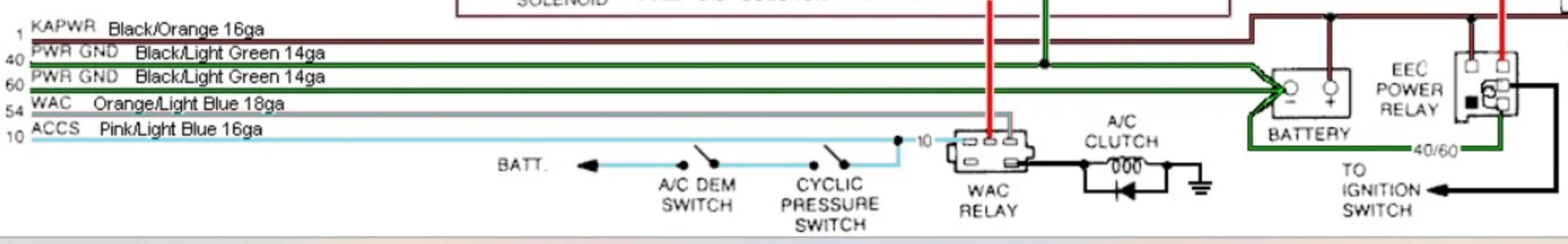

can confirm that the car will fire up if I jump the EEC relay. The relay tests good and a new one was installed to confirm that it isn't the problem.

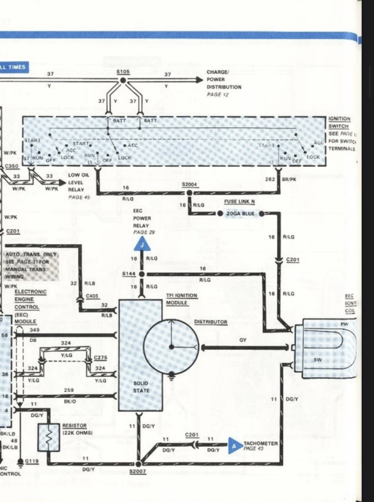

So what triggers the EEC relay to activate?
If you are using the factory wiring, it's triggered off the ignition switch. Wire 16 in the below diagram.
I will have to circle back and check the ignition switch. With a friend helping, I thought we had sussed that out as not the culprit. Thank you for posting the diagram - definitely something to chew on.

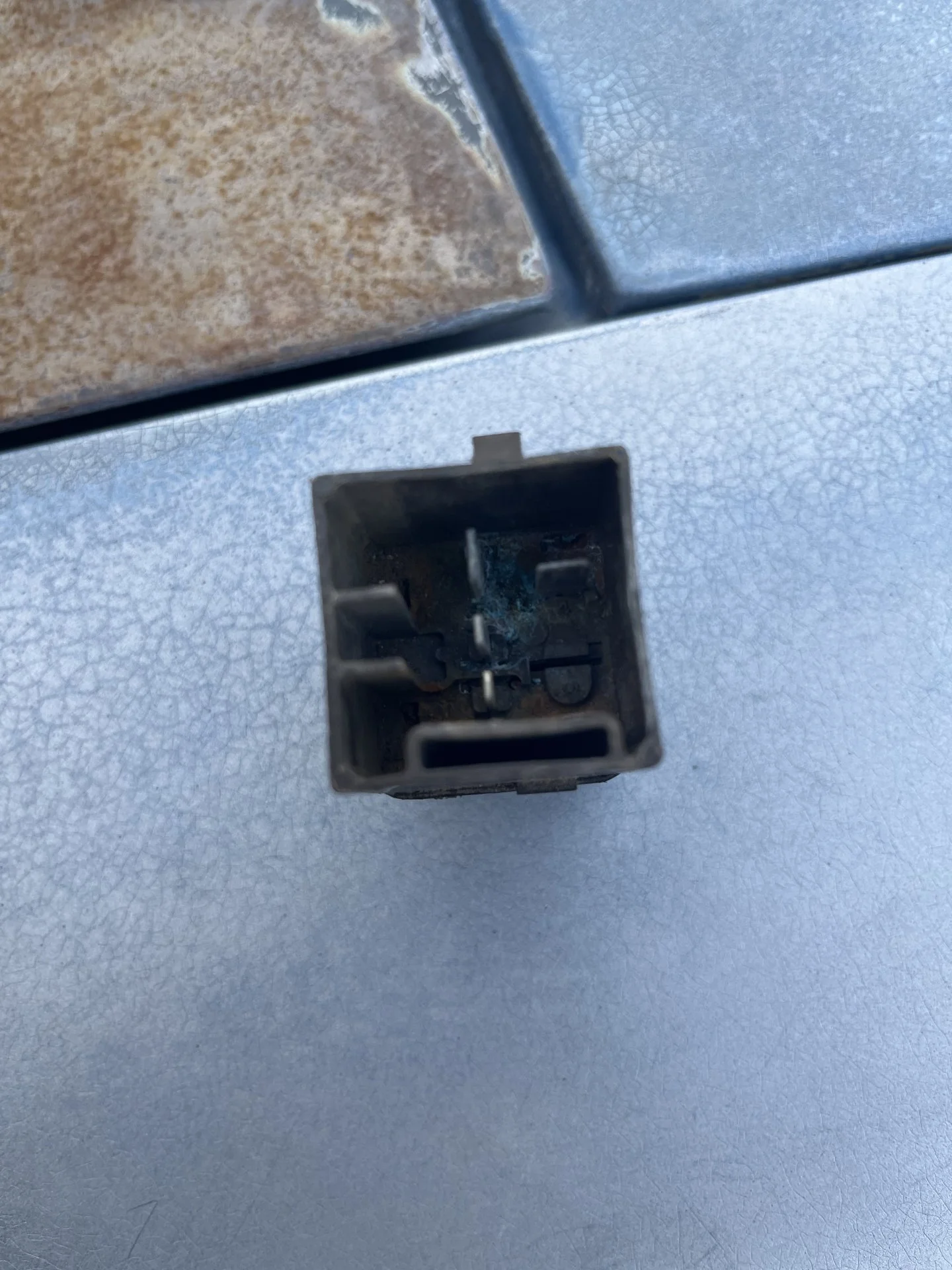

Well I feel real damn dumb.
It runs now.
Hadn’t seen that there were TWO relays in the passenger side footwell. The one that failed was hiding from me. Dug it out, replaced it, all good.
Here’s a pic of the old one (if I can figure out how to attach it).
