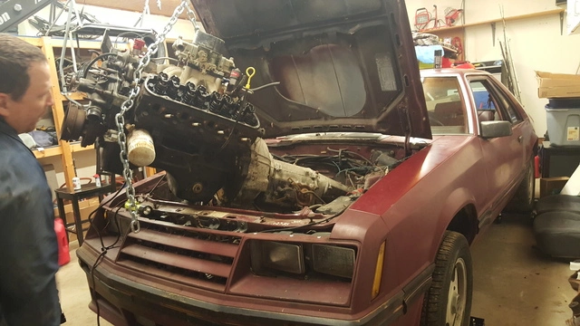

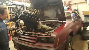

Sounds like your cable might need tightened up a bit. My 98gt (t45) does the same thing. Also, it will scrape a little every once in a while if I shift to fast and don't quite get the pedal all the way to the floor. Wouldn't hurt to try tightening it up just a little and see what happens. It took quite a bit of tweaking with my 88gt clutch cable (new clutch, throwout bearing, pilot bearing, clutch fork, cable, rebuilt t5, quadrant, flywheel, and firewall adjuster). I still had trouble adjusting it to the new clutch, though. I recently pulled the motor and transmission for some upgrades and to straighten out the engine bay. While it's out, I just went in and shimmed up the pivot ball stud to give me a little more "meat". The new clutch, although I'm happy with it, didn't sit quite like the old one.
