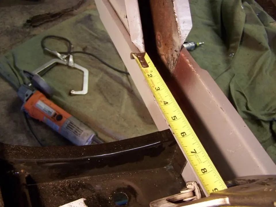

Anyone have a dimension for the floor crossbrace?
Mine was crooked when I took it off and I want this one straight
A dimension from the rear of the frame rail would be good.
I clamped it and measured about 5 1/4 inches but I'd like some verification

I've got a 69, which should be the same I think. I can check it tonight. Just to be clear , are you looking for the measurement from the rear of the floor support to the back of the transmission crossmember?
This one:

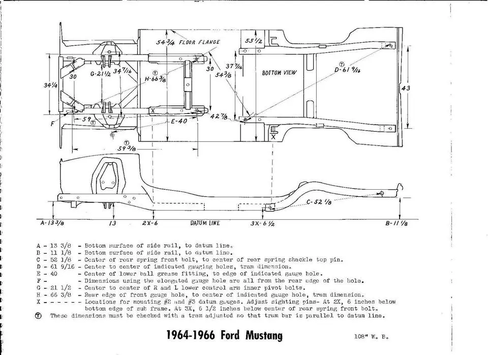

Sep 28, 2010
  • Sep 28, 2010
Does this help?

Fstbk said:
Does this help?
No. I have this one and another one. It doesn;t give me a dimension. I think I am close enough but I'd like to get another measurement to be sure

Mine are 5" even. Both driver and pass side measured the same. Again, my car's a 69, so there could be difference between it and your 67. Could be a manufacturing variation too though

I got 5" on my 67 conv and 31"3/4 from the trans support to just under the lower control arm bolt on the apron.
