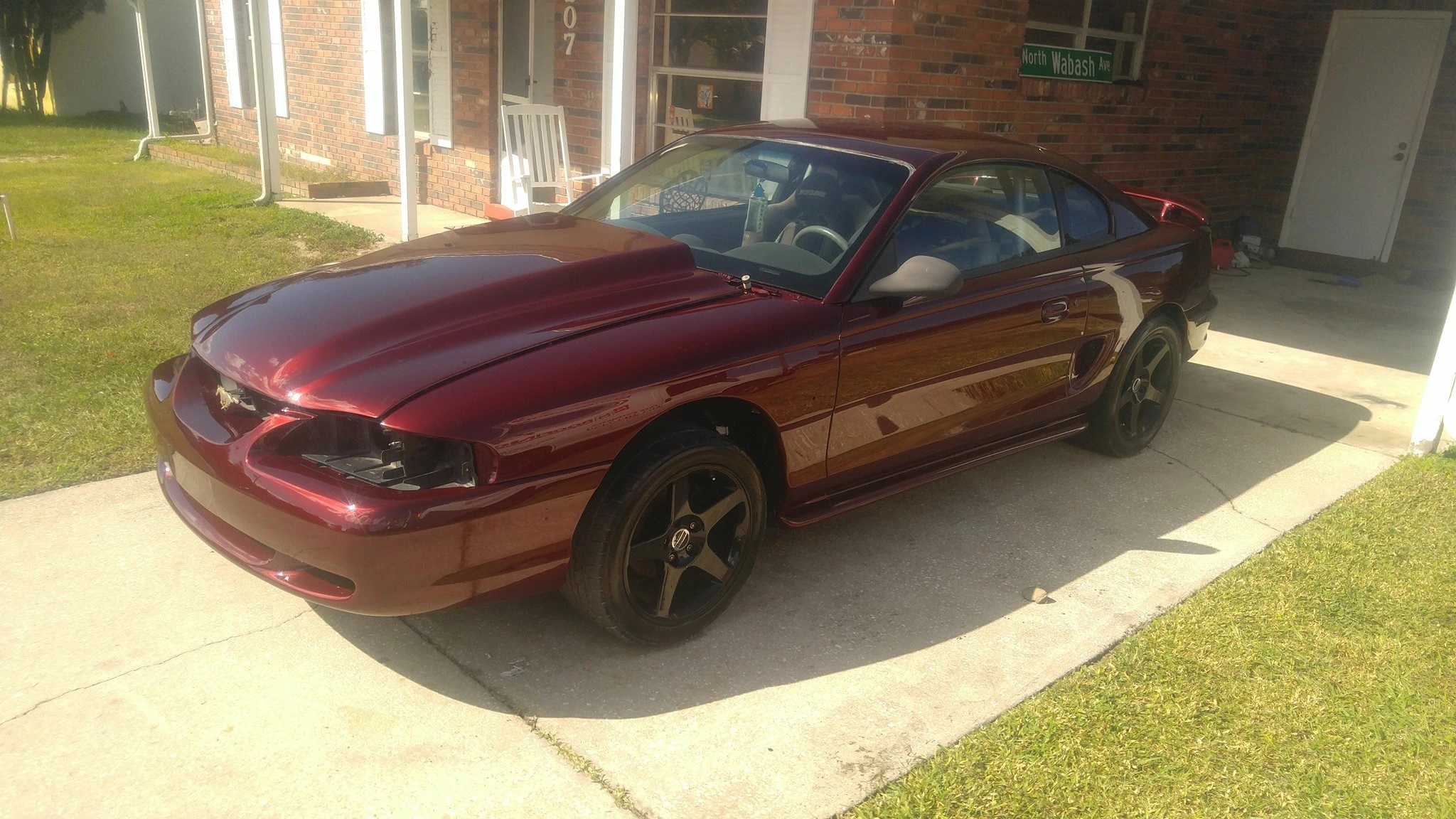

Ok, I'm a painter, so my main view is your mustang is beautiful:nice:!
I hope it goes well for you with the nitrous. I'm kind of interested in seeing how it does at the track. Post a slip when you try it out.
Thanks bud, it's got some iffy spots in the paint because of painter error but it's a solid 5 footer lol. And I will for sure. It'll be a stick car forever. It's got a cage, built rear tubular front and rear everything yada yada yada. I'm hoping for it to be atleast lower 7s range in the 1/8th.
