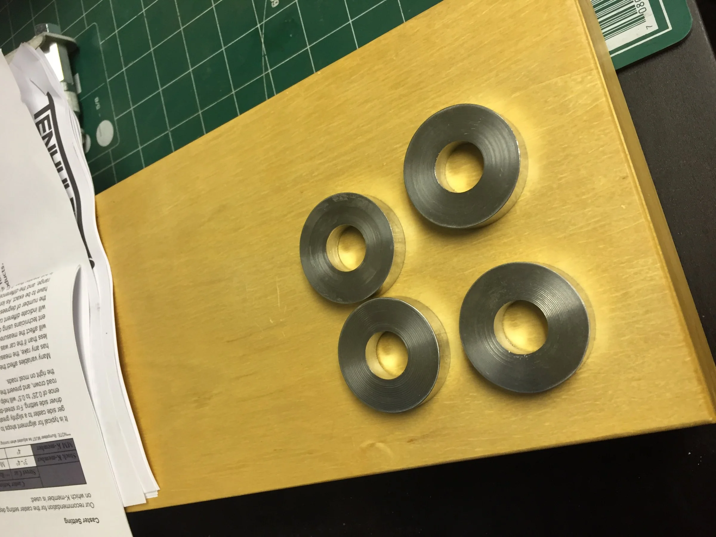

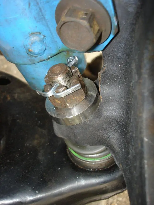

All you are doing is this.
Reactions: 92Apocalypso
super helpful man. thanks. i would prefer to get a single piece like that photo, but that's unlikely I'll find that. will have to get a bunch and stack them like suggested.... previous owner didn't do that m, and that's why the damn castle but blew through the ball joint threads.... the driver side castle but wasn't even hand tight. only a matter of time

you're the man, I appreciate that offer. however, i hope to not have it down that long. I'm at my buddies mercy. car is at his shop. if I can't locate anything like it, I may use washers temporarily, and maybe I'll buy a pair off of you and put them on thr car next time i am working around there.
