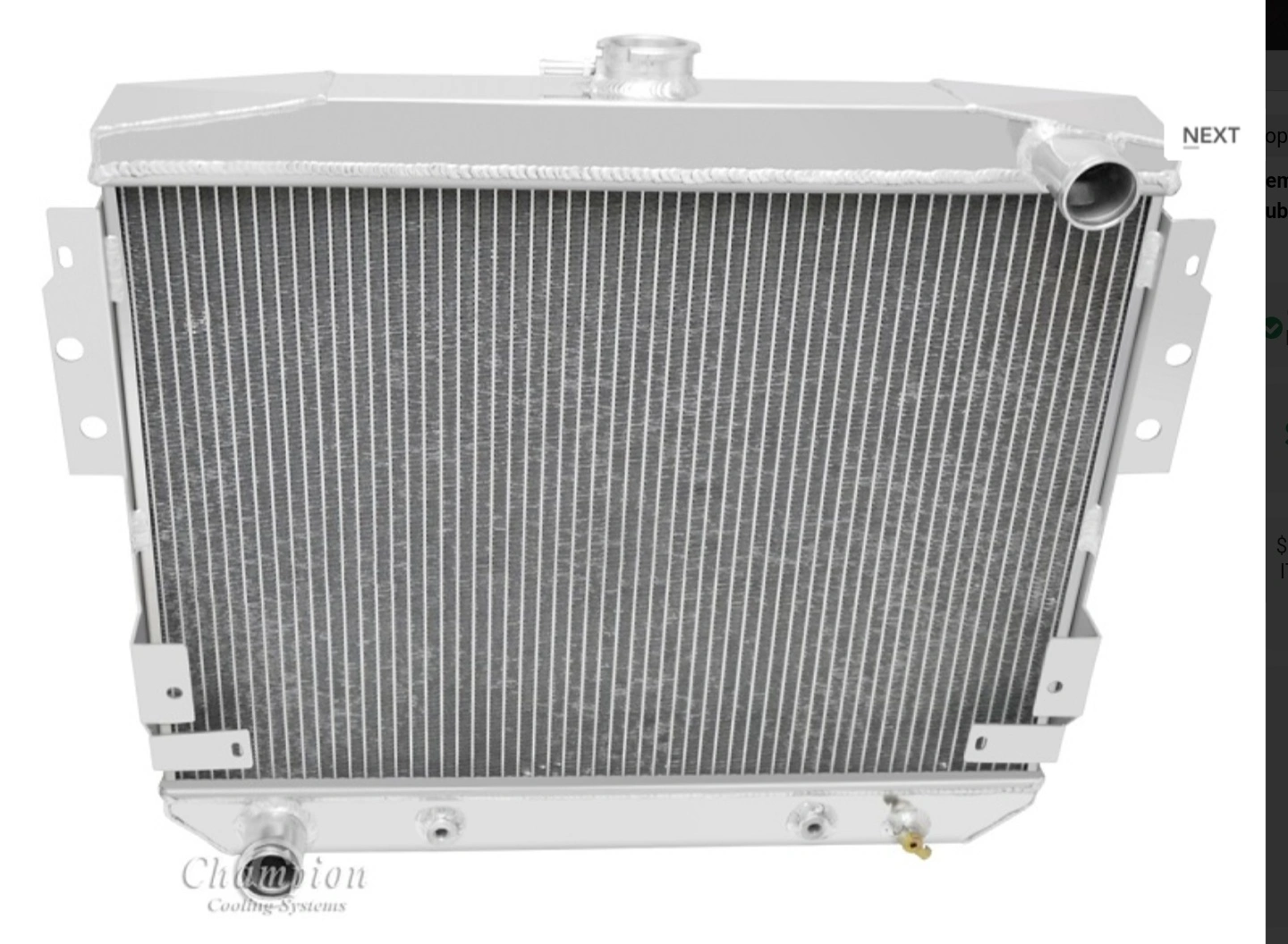

A V8 radiator might work. I guess it would depend on 2 factors: the diameters of the hoses and the orientation of the inlet/outlets on the radiator. Here's a stock pic of the 8 cylinder radiator to assist with the orientation question. A quick search and comparison on an auto parts site like OReilly's could probably yield the diameters. :shrug:
As far as where to pick up a replacement, I was able to pick one up from an O'Reilly's years ago and it's what's still in my car. I honestly couldn't tell you if they're still available or not now though. The above pic was taken from Champion radiator's website. This one is obviously aluminum....

As far as where to pick up a replacement, I was able to pick one up from an O'Reilly's years ago and it's what's still in my car. I honestly couldn't tell you if they're still available or not now though. The above pic was taken from Champion radiator's website. This one is obviously aluminum.... I'll tag @jozsefsz since he still runs a 6, he may have a better answer than I.

I don't see that they carry it any longer. Finding a non-aluminum one is getting to be a challenge. The v8 radiator is a few inches wider than the v6. The hose locations roughly line up, though not sure if the hose sizes would. That would also cause issues with the fitment of the shroud if you're going for a stock look.
US Radiator did seem like a good source. There are a few used ones on eBay, and of course old-fashioned radiator repair could be done too. Me, personally, these aren't million-dollar collector cars. The aluminum is a nice upgrade for cooling and will be less prone to corroding away. There's also this if you care about the appearance of stock: https://www.eastwood.com/ew-radiator-black-12oz-satin-finish.html
