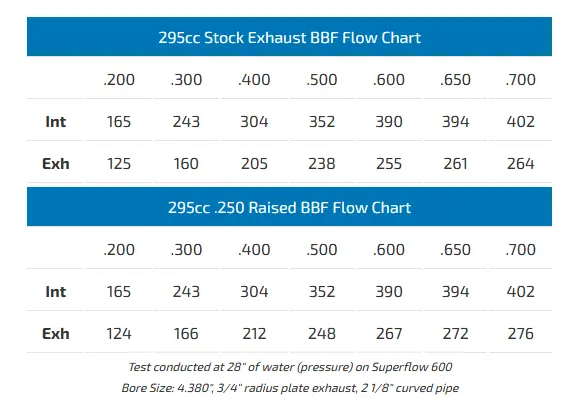

Again…a 460…as big and heavy as they are, with heads that are now available for that engine, ( intended to feed 460 c.i. or more) will make more torque, look way more impressive than a 351 in a fox engine compartment, and live well beyond expectation, making the same or more power for way less money than that yawn-ese 351 Windsor.
...and these are the mid-sized AFR BBF heads. These numbers destroy the CJ, SCJ, and Blue Thunder heads I used to run. They're not cheap, but you're not building a BBF to save money.
just the same…these heads on 514 BBF will make more power for way less money than any mega stroked Windsor will be capable of..
