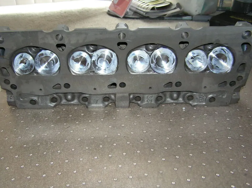

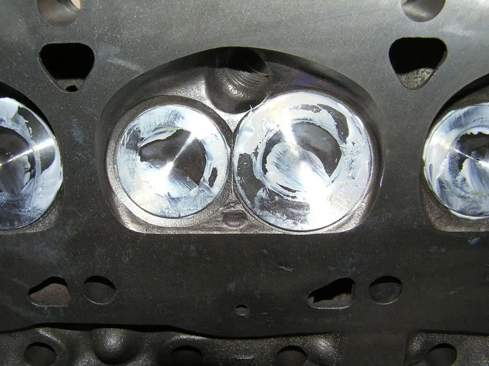

Here's pics fresh from the machine shop:
so these wont work with stock motor, being 2.02 valves. i'm on a budget on getting a heads right now and it seems like people are saying i'm better off with a GT40p heads or if i can save more money then get the TFS or AFR heads. I just dont want to waiste my money and something that wont work. I appreciate your help, i guess i will be in a market for a GT40 P for now.
I was thinking the same thing when you said 2.02 valves that they probably wouldn't fit. Keep in mind if you pass on them and get P heads, you're gonna need custom P headers that will set you back another 200 or so dollars. You might want to just be patient and put aside money till you find a set of good used aluminum heads or standard gt40s
I wouldn't spend a fortune on the Windsor heads even ported because if you're gonna spend anywhere near $500 on those heads, you can just save up a few hundred more and be patient and find something aluminum for that price. My heads are working out good for my combo, but if i had played it different i could have some used Twisted Wedge or AFR 165's for what i have in them. Plus you're taking a huge gamble with the port work being good work or just someone hogging them out with a grinder. Also as already stated the 2.02 valves won't clear the stock valve reliefs unless you go through the huge task of notching them. So yeah, my advice would be either 1) go with P heads and either get Mac shorties for P heads or Mac full length headers since they clear the spark plugs, or 2) save up and buy some nice used aluminum heads. If you come across regular GT40's for a good price, don't pass them up just because they're not P's...the difference isn't really that big of a deal to pass on them, and you won't have to use special headers with them.

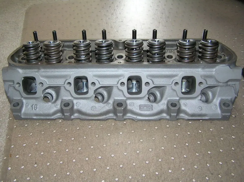

i found this also for the same price of thumper.
Ford GT40P Remanufactured
289/302/
60cc Combustion Chamber
Pedastall Type Rockers Used
Positive Oil Control Seals
5 Angle Valve Job
Stainless 1 Piece Swirl-Polished Under-Cut Stems 1.940” Intake Valves
Stainless 1 Piece Swirl-Polished Under-Cut Stems 1.540” Exhaust Valves
AWSF-32C Spark Plug
Springs Good to .550” Lift, (Hyd. Roller) *check cam manufactures specs for compatibility*
(129 psi @ 1.800” / 280 psi @ 1.300”)
