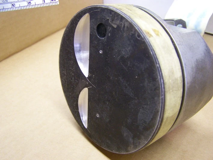

I'll try and get a pic of my flat top stock pistons and post it then everyone can see how much we had cut out of them. It's not much, and that was on a flat top. That's why I think even with the stock pistons I'll be alright, considering we mocked it up WITH the 1.7 rockers.

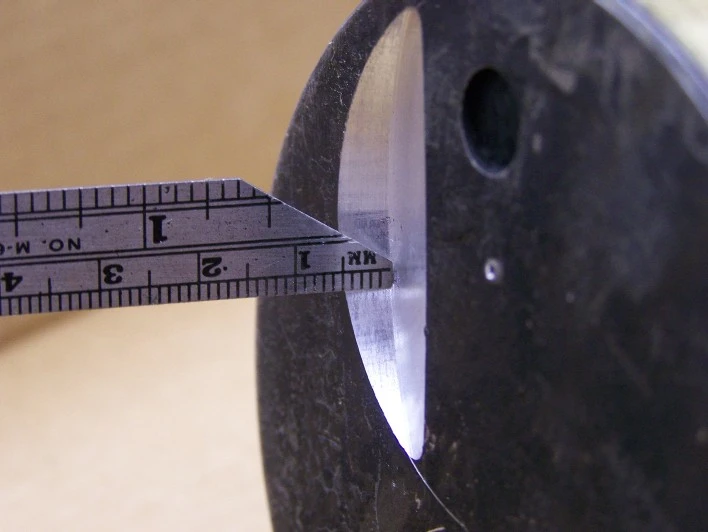

Here is the machining we had done to the flat top 1986 stock pistons in order to add additional clearance for the Lunati cam. Mind you, I'm almost sure we had clearance without doing the machine work.

You might have had clearance on any other year piston but the '86....because those don't come with ANY valve reliefs....it's kind of the "86 curse" and you'll see a thread about it almost once a month, someone asking if they can use whatever cam and then having to be told about the pistons in their car....
Since those pistons are probably the exact same casting as the '85 and '87+ only minus the reliefs, i think you'll be alright with the cut reliefs. Personally i just get nervous about the idea of taking away material from a piston that isn't bullet proof to begin with ya know? I've seen pistons break right at the outter eyebrow area of the intake relief. Either way it's a good idea to still check the clearance....it's only like a 5 minute check.
