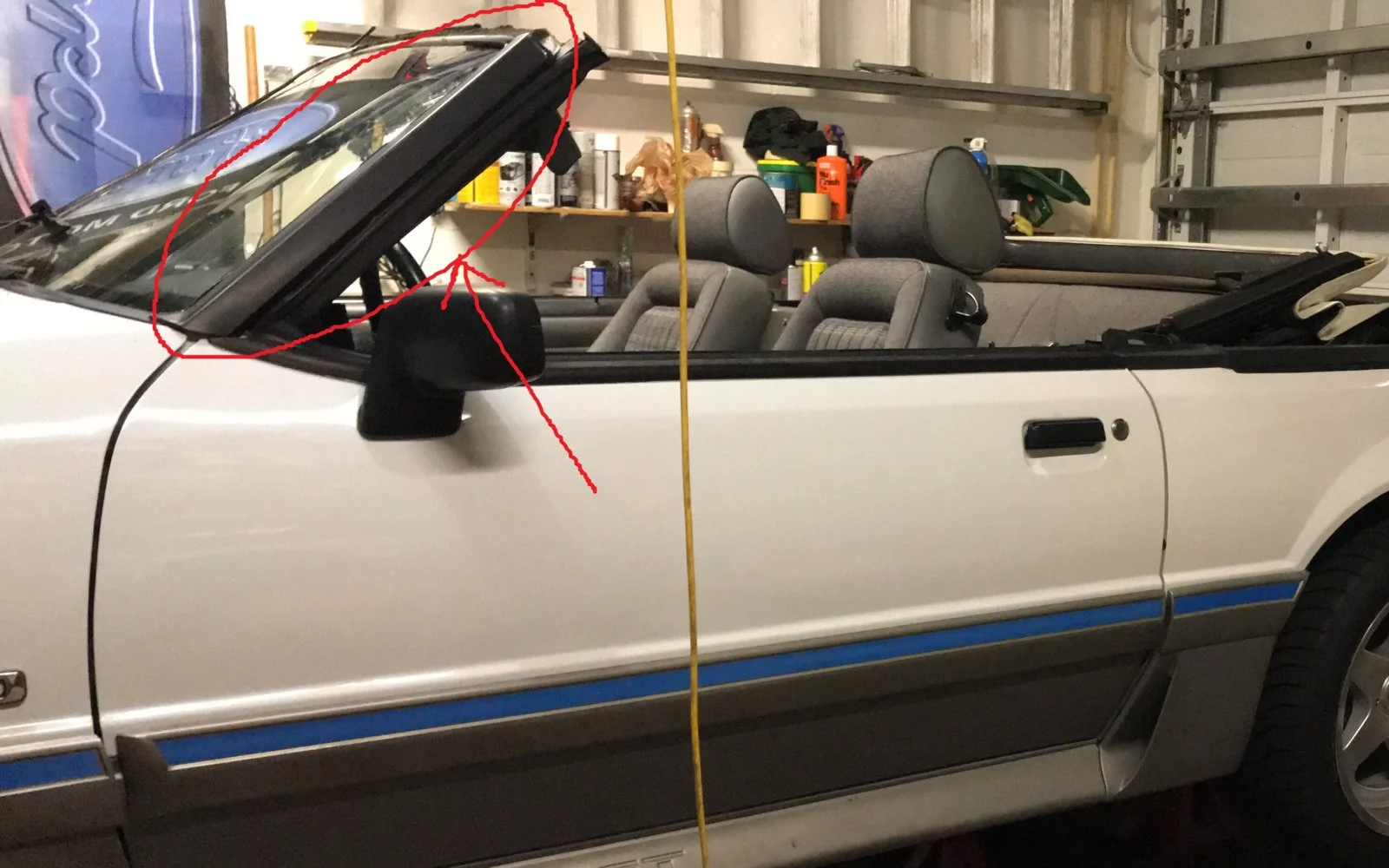

Does anyone have a video or a link to a video that shows how this trim is installed (see pic)? I took mine off and I am not sure that even did that correctly, so that I could paint them and now I need to reinstall and I think I am missing something. Any help is appreciated! Thanks.

They slide down the a pillar from the top. Then you install the metal strips that hold the weather strip seal. The strips have phillips screws in them.
The a pillar converts go on first.... and then the top ( above windshield ) covers.
