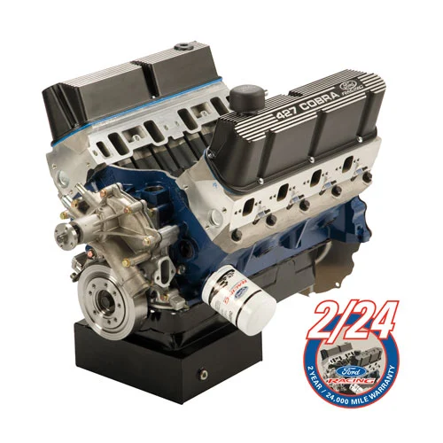

There's always the 351W-based Ford Racing Engine that displaces 427 c.i.d., rated at 535 h.p., MSRP $9249.00. This engine would fit in any Mustang ever made with no modification of the engine compartment.
