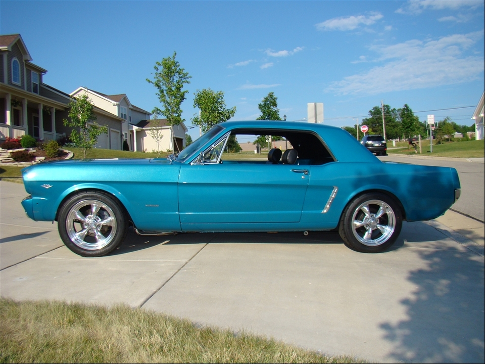

Here are a few pics, regular wheel weights did hit my upper control arm as well, I just switched to the sticky weights and it solved that problem.

I have 17x8's 4.5" BS 235's Granada brakes. Wheels fit the same as stock drums.
Old pic.
Old School Saleen wheels!!

As far as the Granada's go I really couldn't tell you for sure as I did it so long ago, but as Z06killlin stated I am pretty sure they did not.
The 2005 GT rotors I only test fit in the wheels with a hub, but that being said the rotor is probably slightly thicker then drums were- but that would be minimal, and shouldn't be noticeable or effect anything.
12sec67- Thanks, just an FYI I will sometimes get a bit of tire rub with the 235s on full lock of the steering wheel, but thats a rare occasion.
