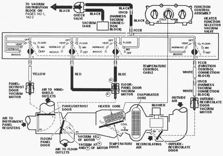

Need help ASAP! My A/C is not working, and I have my whole dashboard apart!
Could someone point me in the right direction where to look? I can only find one real vacuum hose, and It was broken, but I fixed it. All the fix did was make my floor vents work. I took 3 pictures of everything. Maybe somebody could help me where to look.... Thanks,
Joe
Where the two hoses meet, there is a small black connector, right? Yes, that part of the hose was broken (at the connector) when I fixed it, I regained my Floor Vents (Cold and Hot) so my floor vents started working, but my main panel vents still do not work
