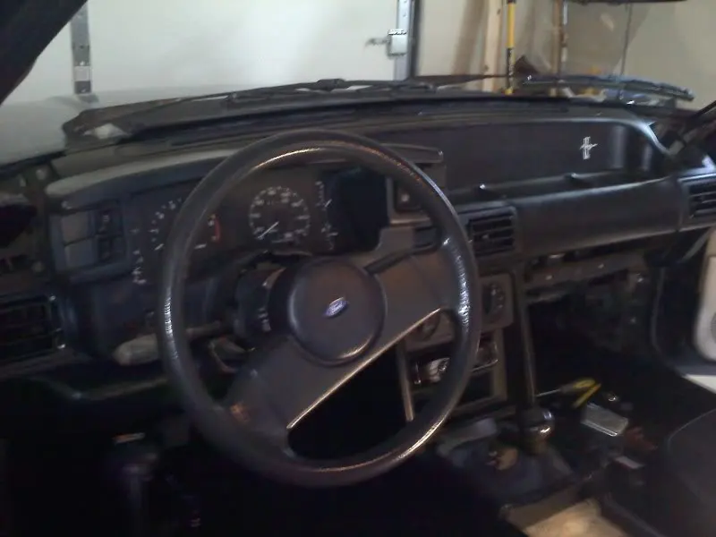

Hey guys....it has been a while since I have been on here. I am hoping some of you may be able to help. I sold my notch and have been out of the mustang scene for a while. I am currently working on a project for my buddy. Changing over the interior of his police notch to all black.
He found alot of parts on craigs list which helped. Complete dash, which I already swapped out and other stuff. I believe the donor car was a 90 or newer which causes a problem for the rear seatbelts and rear inside quarter panels. The 89 and older only had a lap belt and the 90 and newer had a shoulder harness. The rear quarters will not work unless you use the shoulder harness style seat belt and I do not thing there is a way to mount them in this 89. If I still had my 91 I could look how they are mounted but unfortunately I do not have my car any more.

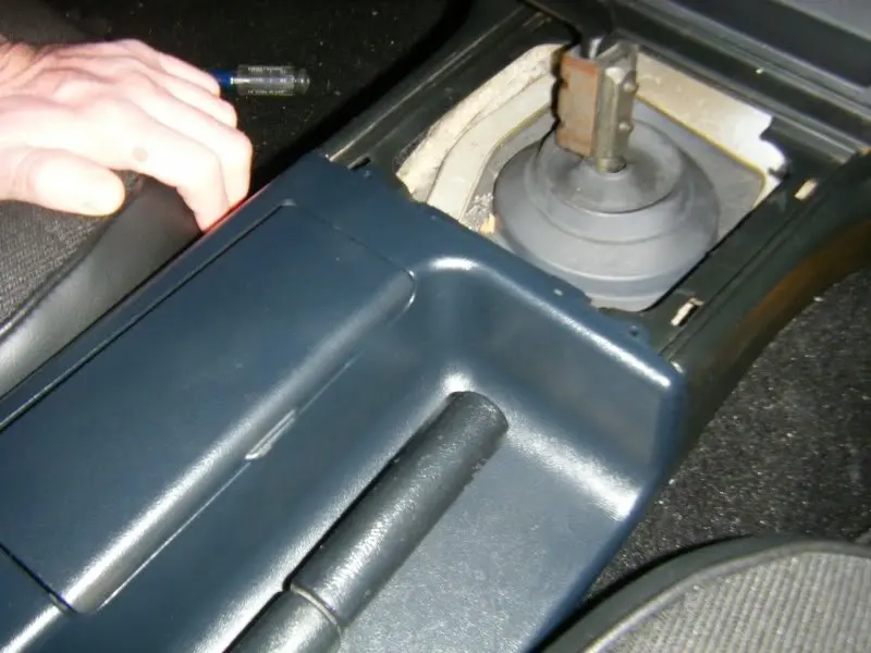

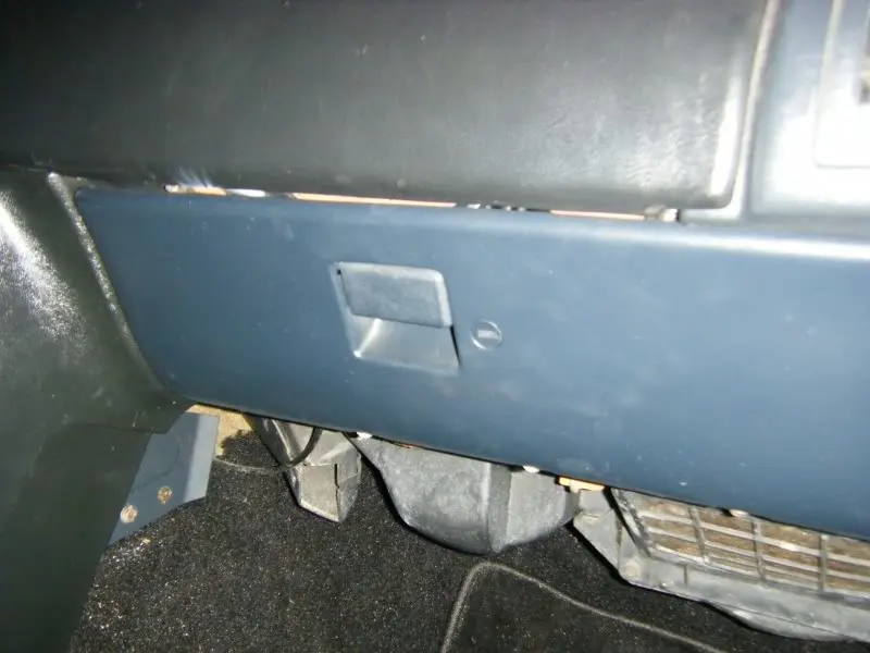

Other problem I ran into was painting the stuff that needed paint. I ordered black interior paint 90-93 from latemodel restoration and after painting everything it was dark blue.....they are mailing me black for 79-93. I hope it is black this time...don't know if they labeled cans wrong or what. It sucked having the stuff painted and then bolting it on and seeing it is different. In the garage with the limited light I have it looked black.

As for paint. Nothing matches, or it scratches off...especially the console. You might get away with the glovebox, but in a year or so, the tan will start to wear through. I painted a few of my parts when I put a black interior in my '88, but ended up later buying oem black stuff because in the right light, it never matched.

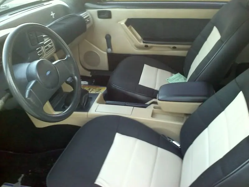

Btw, that beige interior was very clean and very rare! I would have left it. Black interior shows all the dirt and dust :(

ya i know i know...i def looked black in my garage....lighting isn't that good. Once you got the stuff into the sunlight you could tell. It looks even more noticeable in the pics because of the flash from the camera.
The tan interior wasn't that nice at all even though it may look so in the pics. The only nice thing about it was the new black carpet and the seats were previously redone. I already died the rear seats black and they came out good. Going to do the same for the fronts.
The dash was beat up and stained and the rear quarters were beat up and cracked.

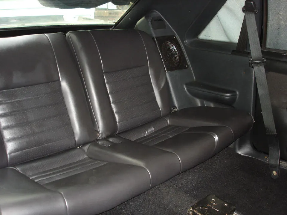

Also, the 1 problem with the rear quarters being different is like Mustang5L5 said with the upper belt hole mount but also the top rear of the quarter where the shoulder harness would mount. If you put the newer quarters in there without the shoulder belt there is a gap. It doesn't go all the way back to meet up with the top back carpet piece up top. So I guess I will have to find quarters from a 79-84.
I don't think I can use 90-93 rear quarters without the shoulder belt because there is a gap there. If you can understand what I am saying. And I guess the only way to use shoulder belt is to weld in the support and I'm not doing all that.

Thanks for all the help. And don't worry I am not taking offense. Like I said the pics made it look 10 times more noticeable with the flash then in regular light. I was actually shocked when it was that bad. I first showed my buddy in the garage and he thought it was black too until I took the picture.
