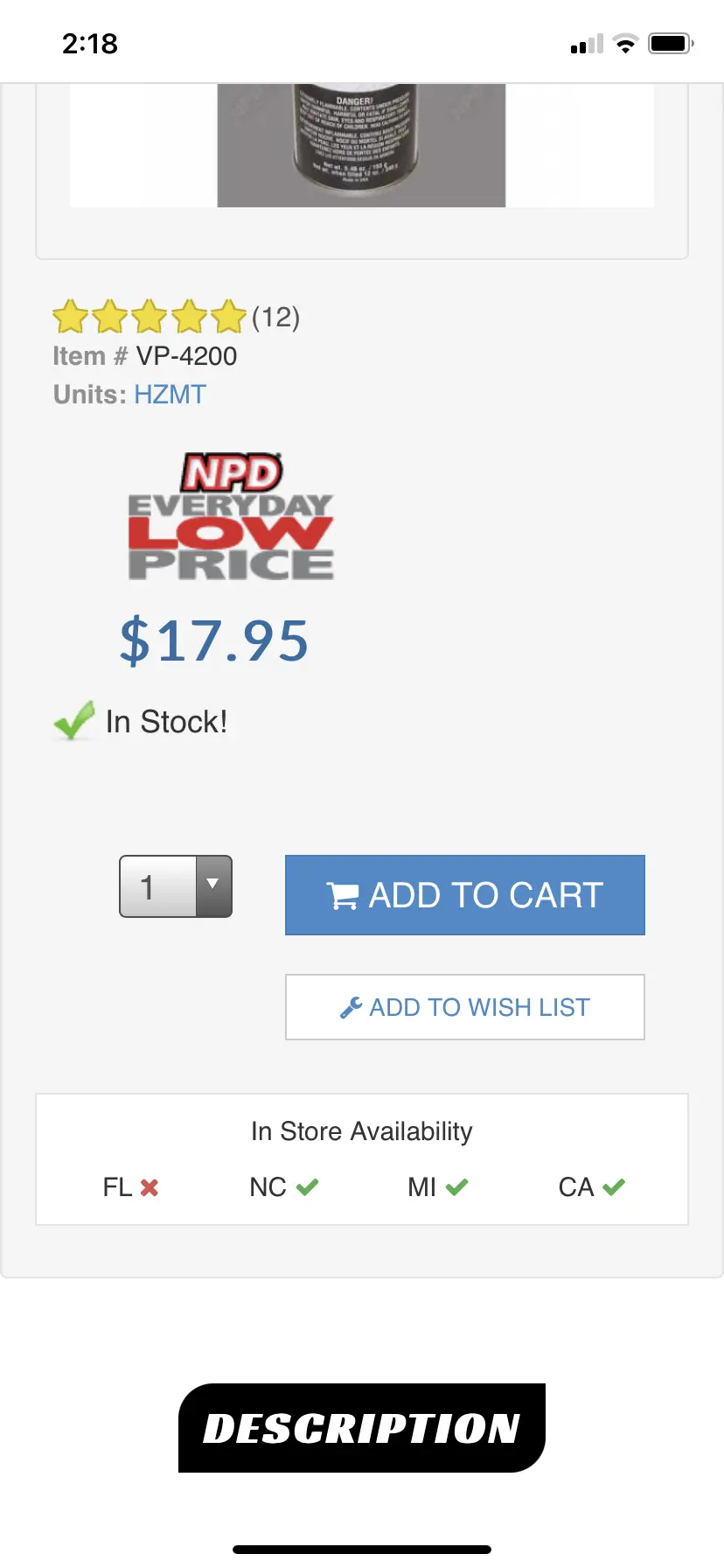

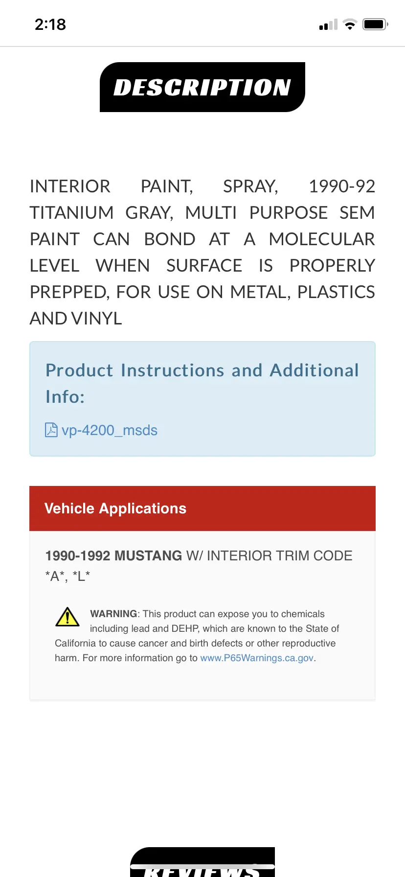

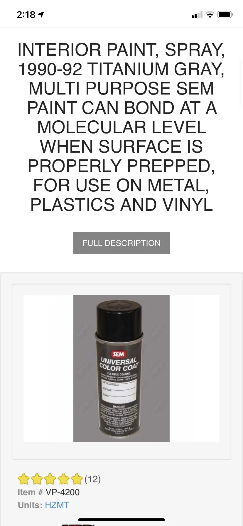

I have a 1991 LX with Titanium Gray interior which needs to be sprayed to match as well. Recently in Jan 2021 I purchased Titanium Gray SEM interior spray paint from “National Parts Depot” and the color in my opinion is spot on! NPD mixes it themselves. The part # on the can says 15993 and the sticker that they added to indicate the color is VP-M4200H color code P semi-gloss Titanium for 1990-1992.
I did a test area in the hatch and it matched perfect.

Try this link if interested in NPD paint:
