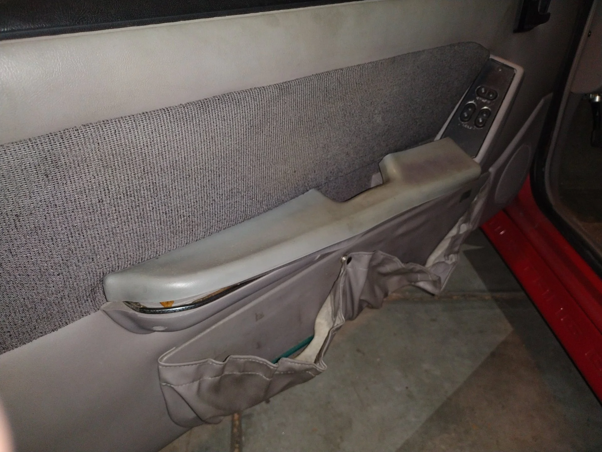

Here's a picture of the one I'm replacing
Would need to see the dash really. That's where the differences are. But from what you've posted, it should be a 1990 and that panel does look like a 1990 panel gray, although very dirty
Yeah the whole interior needs a good cleaning.
