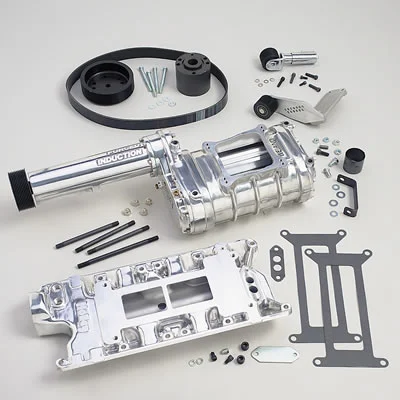

Now THAT's a street blower! :D
WEIAND
First of all, see if you can get a deal without using their bonnet or carb application because it is garbage. I gained 50rwhp switching to a superiorairflow.com bonnet. You can then use whatever carb you want and have it tuned appropriately. I think there is more info about blow through carbs on turbomustang.com. Also, if you do it that way it will be very easily to buy a mandrel bent 3" 90 pipe to go from the s/c to the carb and you can mount a BOV on that instead of a bypass.
