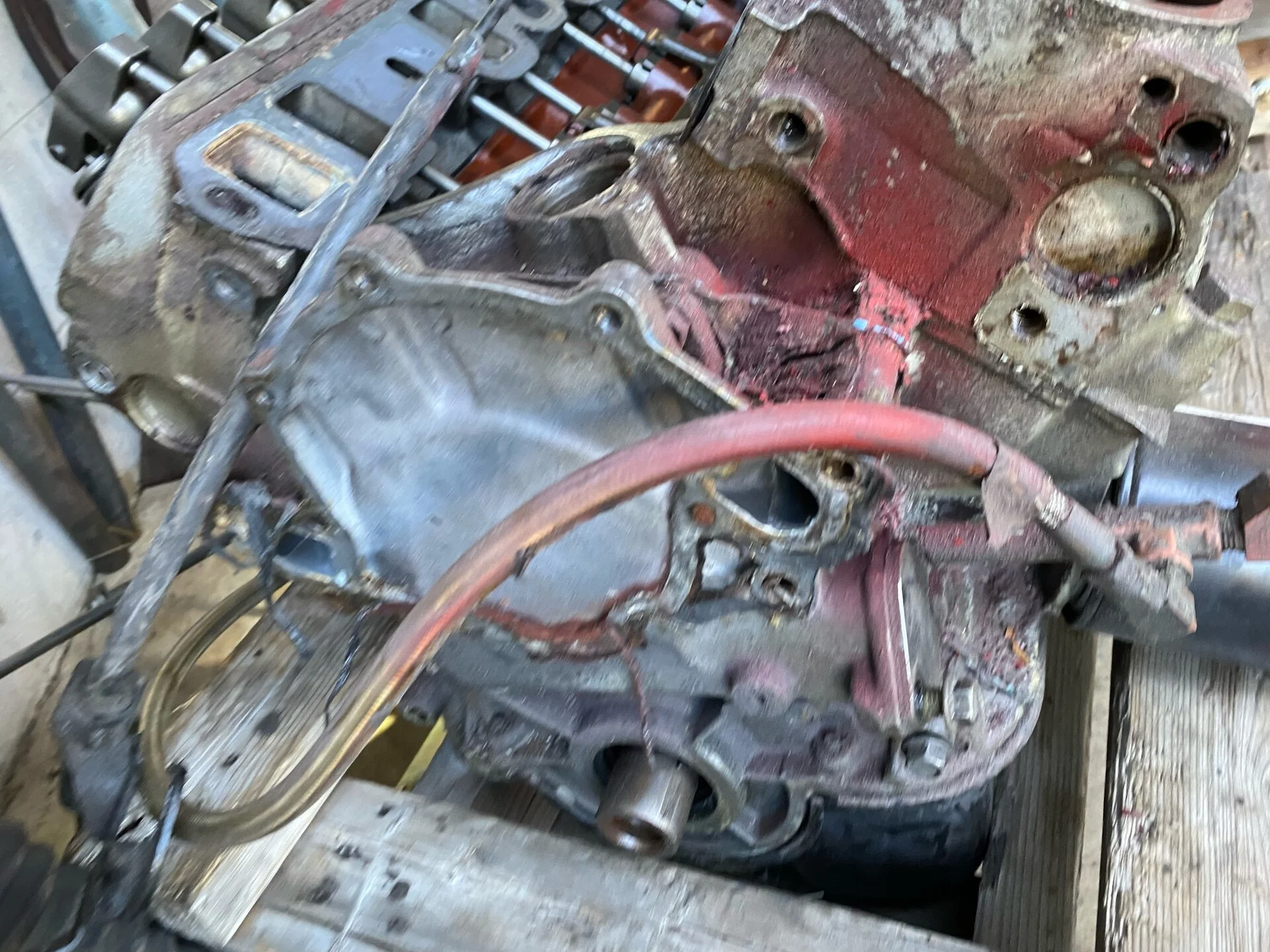

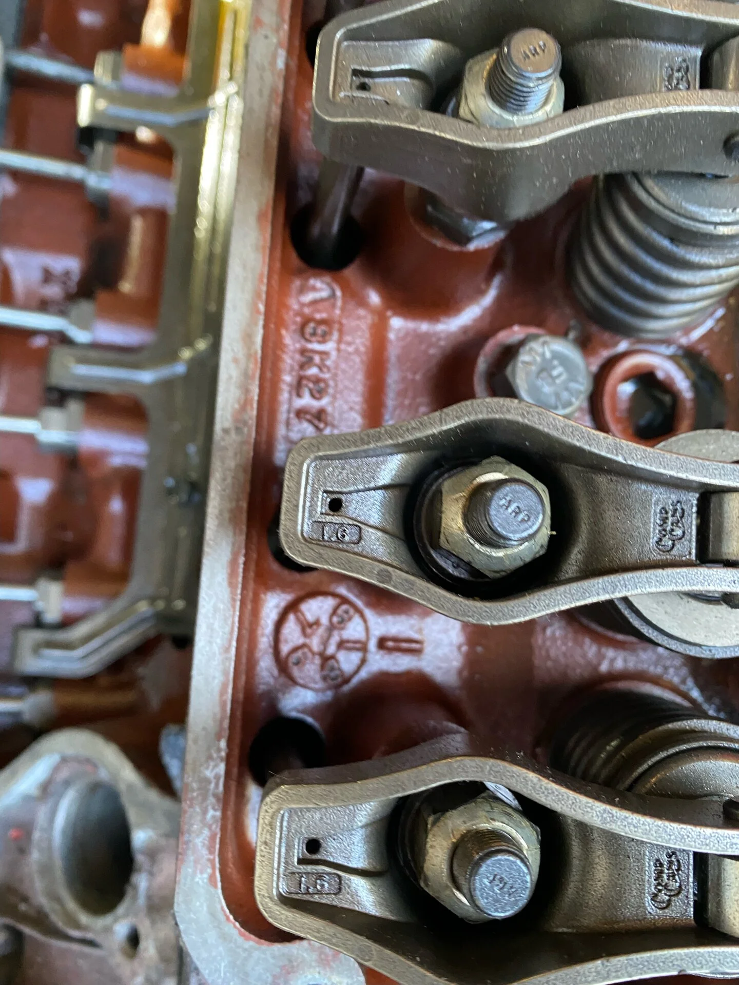

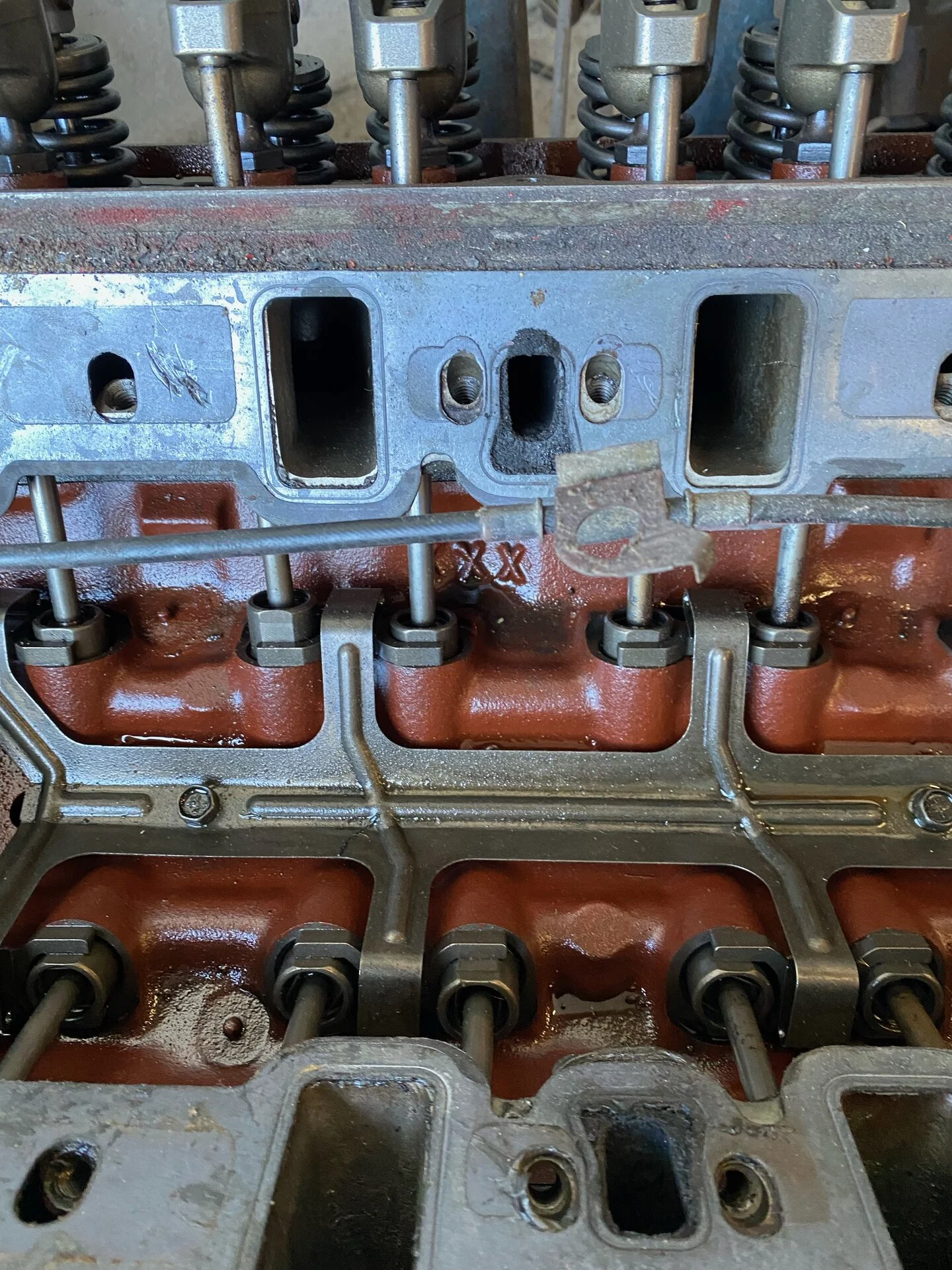

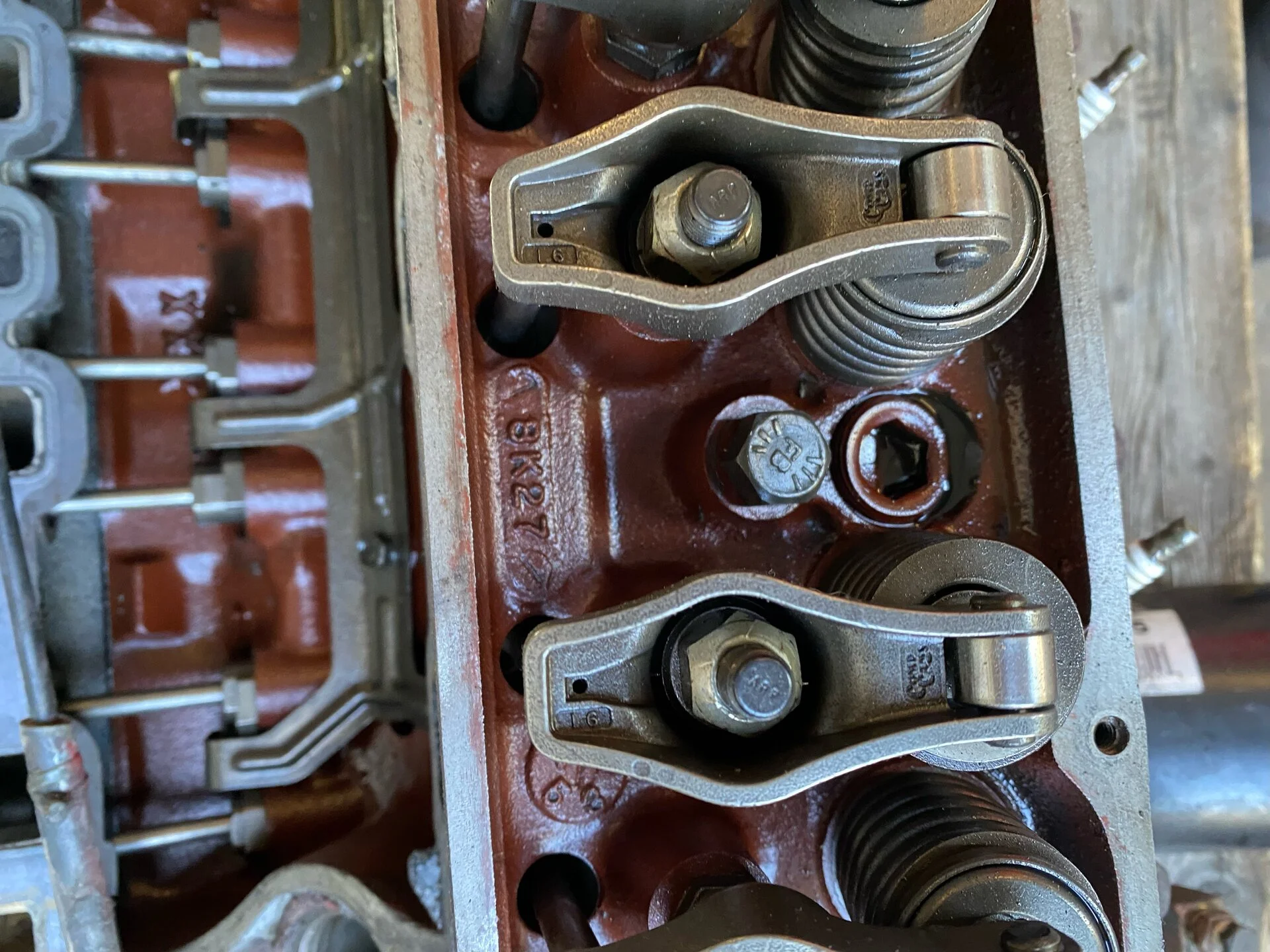

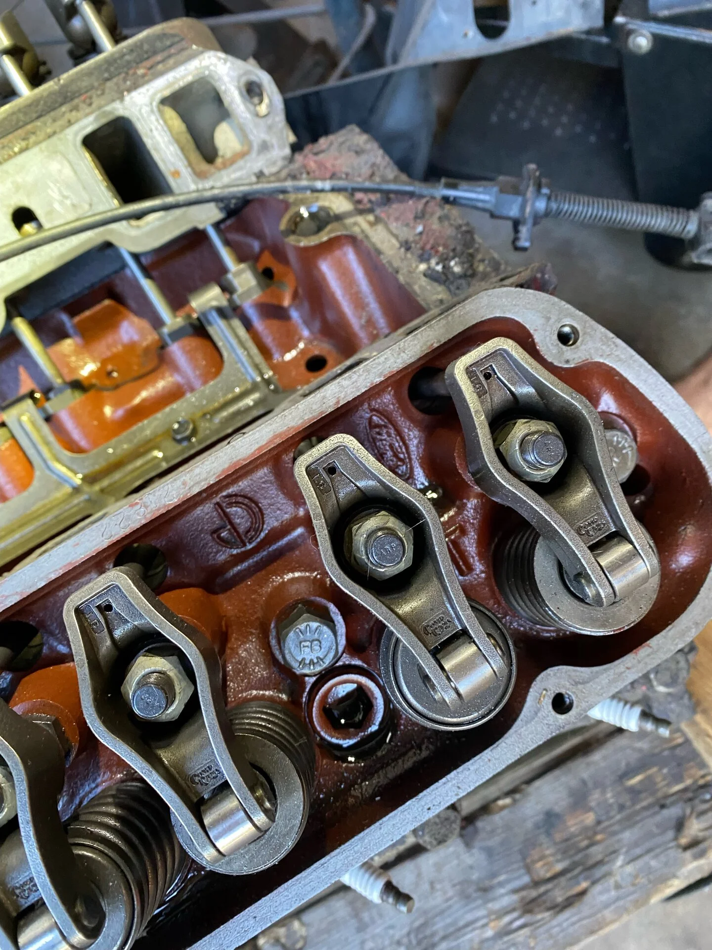

Can anybody provide me any information about this block and heads?
This engine was making really low compression numbers, I had another built to replace it. I would like to sell the old one, but I dont know anything about it.
Any help would be appreciated, I can get more pics after the weekend if that is helpful.
Thank you

I think the date code is on the block where the starter would be located, if you can look inside the spark plug hole and see the top of a piston that would tell if it was a low compression engine like from a truck or crown vic/grande marquee, there may be a engineering or part number someplace.

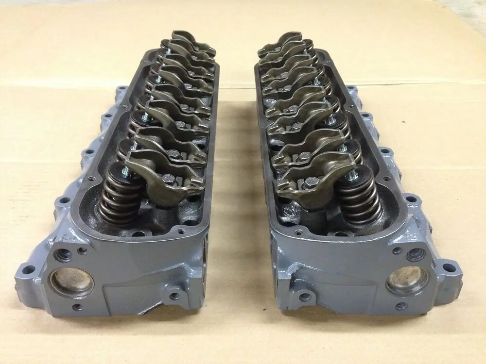

The spider, dog bones and roller lifters look factory. The roller tip stamped rockers and plug angles look like the heads should have three bars on the ends. I do not see the bars on the ends of the heads.

The 8K27 in the head should have a letter before it go be a Ford part number. And many from the era of what the block looks like have a thermactor port (or plug) in the ends of the heads. Are the heads iron?
Do I you have any more history on this long block?
8K27 is a casting date code.
October 27th, 1988

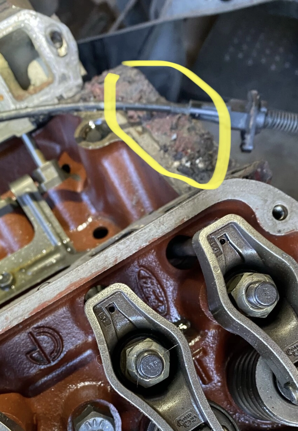

Those heads look like standard E7s given the “CP” foundry mark (and Ford emblem) The block has its casting numbers near the starter. I bet it’s an E7TE block with a 1988 casting date code.
If you clean up this spot, there might be a partial vin here
How bad was the compression? Someone dumped money into that at some point, Its a late model block and E7 heads, prob .030 if the spent money on glyptal paint and a stud conversion. Bet it has a cam in it to lol.
The glyptal paint stood out to me...... Someone might have spent some time on this long block... I would check it over.... It might end up with a rebuild on an engine stand.... NOthing cooler than a few engines " rolling" around......
