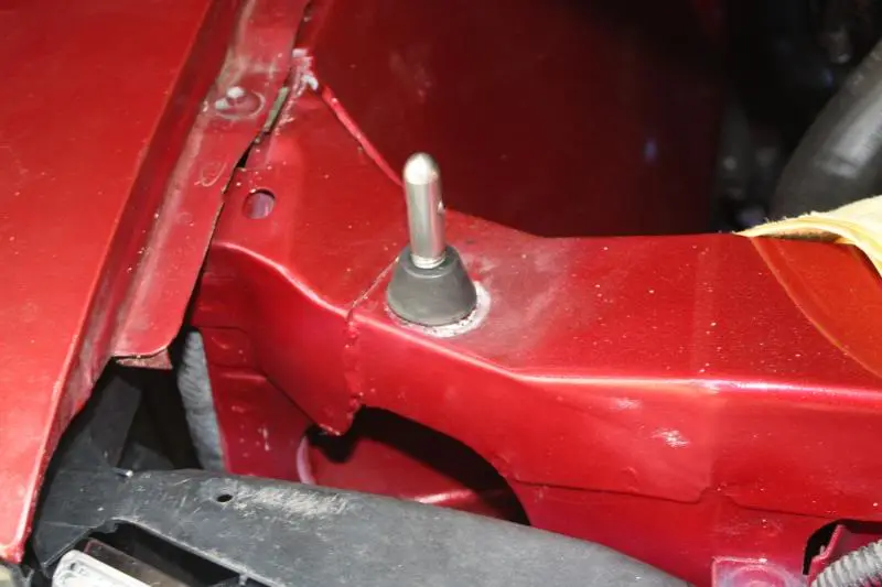

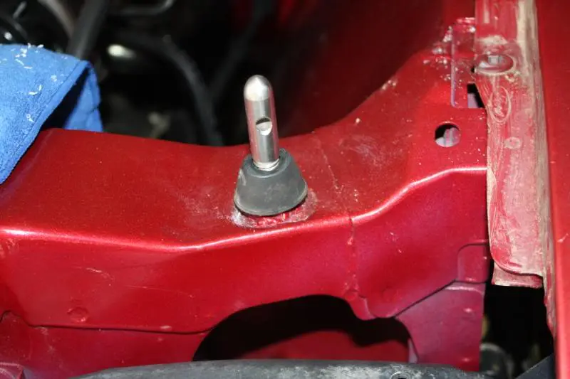

pretty sure my build thread has pictures... i drilled out the base then the rubber bumper which i slid washers over the pin and put the bumper on to make the stops the correct height. if you cant find them ill search later tonight im finishing up some homework.

Thats a good idea with the washers over the pins. I will be stealing that idea now, thanks.

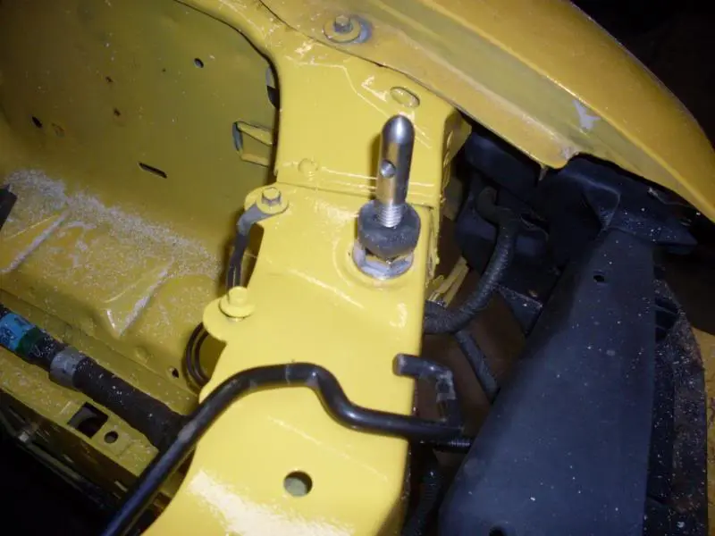

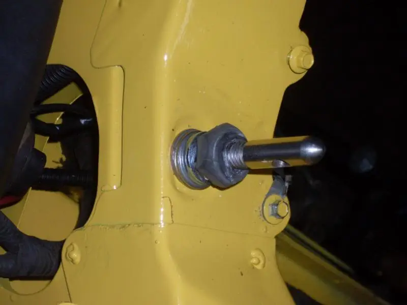

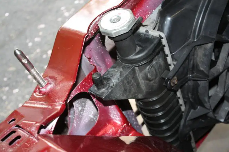

I did the same thing. The only thing I wasn't satisfied with was the base. I didn't feel that the base was strong enough should the hood decide to pop up. That base is designed to level the hood, not keep it from flying off the car. I took 2 pieces of 1/4" steel, and drilled and tapped them. I pulled those bases out, and welded the 1/4" steel pieces directly to the core support. I then locked the pins down with another set of nuts that I had trimmed a little bit. Then drilled holes in the rubber pieces and slid them over the pins.

I welded my top nut to the metal... just tapped them lightly with a rubber mallet to straiten them out.

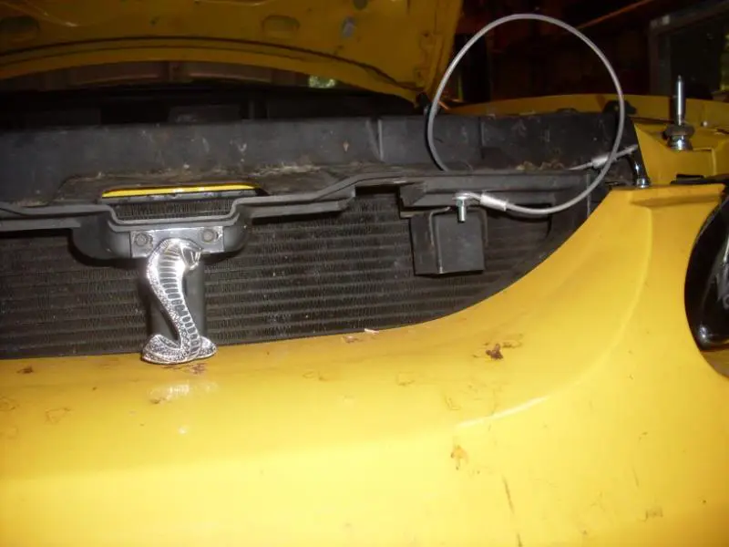

i cut a small slit in the underside of the hood to get the striker plates inside. then riveted the top plates in place
