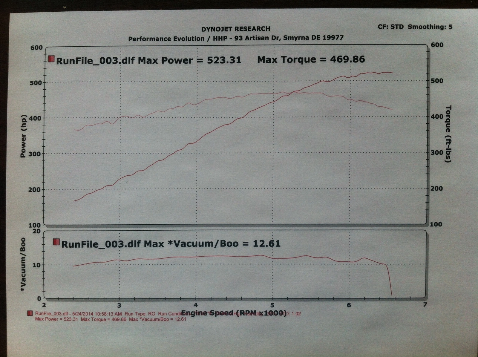

I think it would be wrong to say that a pd falls on it's face up high......I just had to increase the limiter on my ecu at the recommendation of sneaky to spin some more high end hp. And I'm running an eaton.....super inefficient compared to other blowers. And I'm still running n/a cams losing a lot on low end. Planning on stage 3 blower cams this summer.

What cams are you running? Depending on their exact specs, they may or may not be causing much, if any, loss down low.
I'd love to see what kind of AFR and spark your tuner has you running down low. My tuner was scared to run very much spark low in the rpm range until I pretty much demanded that he add some. Wound up seeing significant torque increases below 3500 rpm, and never had any issues with detonation. IIRC, it was a pretty much flat spark curve around 13 degrees or so all the way across the power band with no water/meth, and with the water/meth (via cooler ACTs), it started around 14-15 degrees at tip in, and increased with the rpm towards 22-23 at redline.
Thanks it taken me a lot of time and money to get it there. I'd love to slap a 2.3 tvs on next year
I'd love to see what a TVS could do on a 2-valve. But be sure to take it to the track as it sits now first. Definitely want to see how it runs with the Eaton.
Currently the cams are the set that come in the twisted wedge 2v kit. I don't have specs in front of me. But they're designed for n/a cars more than boosted applications. Down low lost torque until around 3500. I'm hoping to put the tvs in this coming January. Gonna need to either run twin pumps or go return style figuring gonna be another $5000 to install $1,000,000 2v lol
