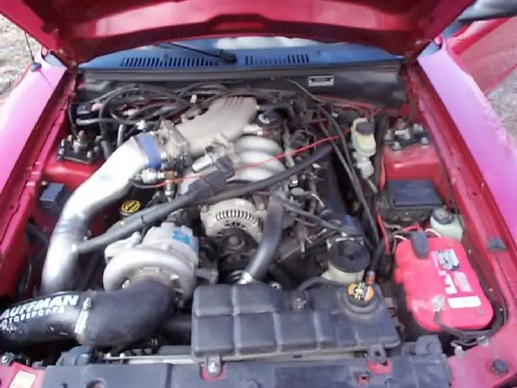

I took a procharger intercooler and did custom piping. I basically copied the way fast track does their intercoolers. I basically took a hole saw to my car right next to my frame rail. This allowed the intercooler tube to come up away from the power pipe...here a pic of how my aluminum tube come strait up till it hits my vortech throttle body tube.

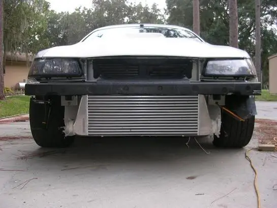

I use these intercoolers ONLY. 1 year warr.
very high quality.
Here is this same intercooler installed on a 99 GT
3" pipe kits can be found on ebay as well. However, I make all my own piping and cannot vouch for any pipe companies on Ebay.
As for pressure drop, the intercooler is listed as a 0.5psi drop. In real life I have observed from 0.7psi to 2psi of drop. Most of the increased drop was due to a customers choice to use smaller piping to save $$. W/ 3" piping and smooth, gradual turns, you should so no more than a 1 psi drop.
REMEMBER: PSI does NOT = HP!!!!!!!!!! LB/min does!!! cooler air is denser, more lb/min @ same psi.
