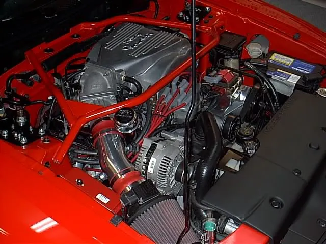

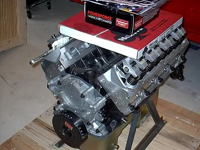

I'd suggest a 347 crate from a reputable company. I got mine from Probe (CHP). It's their 425HP stroker long block (a few years ago $6,250). I added a custom Crane cam since my car is a 94 with finicky ECC. I got the AFR 185 CNC'd heads. I added a Holley Systemax Intake, 30lb Injectors, Pro-M 80MM MAF, 70MM TB, MAC 1-3/4" Long Tube Ceramic Headers, 3" Prochamber, 3" Cat Back. She's a beast with all this.
I'd sell your FRPP Shorties and GT40 intake and use the money for better flowing stuff like I did.
