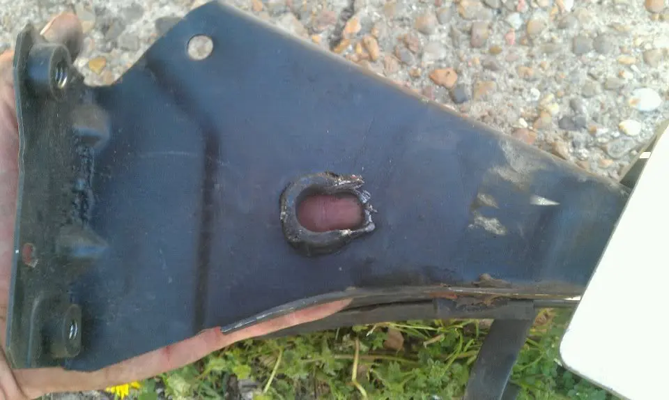

I decided I was going to fix the slop in my 68 coupe's clutch and brake pedals, but when I got the clutch pedal out, I noticed that the pedal support (I guess that's what you would call it, goes between the dash and the firewall, where the pedal pivot goes through) where the bushings go is wore out. The hole is no longer round, but oblong.
The only fix I see is to replace the whole support, along with all the bushings. Is this right? Has anyone else had to do this? I thought it would be a quick fix to just replace the bushings, but boy was I wrong. Now I have to remove the column and order more crap.

Thanks. You're always helpful. What I'm worried about is even if I replace all that, I'm worried that the pivot rod will break through the big bushing, since that big round bushing will be put into an oblong hole.
The Drake kit replaces the white metal eye in the support with a steel eye. Has the steel of the bracket been damaged, too? If so, you'll need the kit with a new pedal shaft.

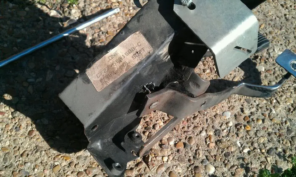

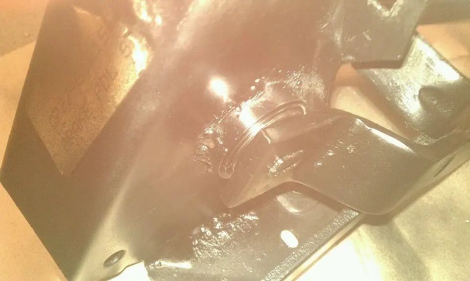

Decided to go ahead and take it out today. Judging by the sticker on it, it's been replaced before. I will definitely need a new shaft, it is cut almost halfway through! Edit: I just saw on the Mustang Steve link a pic of one about the same shape, they said it was still fixable.
My concern at this point is if the hole is too oblong for any of the above kits to repair it.

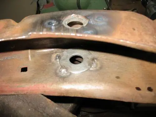

once you start fabricating you can never stop lol i have a miller TIG machine and various metal fab tools + a friend who runs a cnc machine, so i can pretty much make anything lol if i think is worth taking the time to save some cash, or if i want something but dont really like anything available from aftermarket, i modify an existing design and make it the way i want it !
Done!
This is the only (crappy) pic I have of it now, I will probably post a better pic tomorrow after I put it in.
