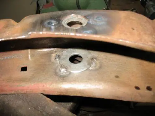

dennis112 said:
Here is what I did using the Mustang Steve kit--it replaces the supports bushings:
Here is the write up of my installation:
http://www.fordmuscleforums.com/transmission-articles/481163-ball-bearing-clutch-pedal-support.html
Oh, BTW, I printed your thread, and followed it exactly. Your post should be the official instructions for the installation of this. First I read your thread, then the instructions which I made sense of only because of your thread. Then we used your thread as the instructions during the install.

Thank You 68stang351. I am glad that the tech article was helpful for you.
As you now see, the Mustang Steve's kit is truly a nice permanent fix that can be used to repair even the worst worn supports.
Enjoy!!!

Wow!!!!!!!
I got it put all back together and I am very impressed with the results! Clutch effort is about the same as my 04 GT, it's very light! I forgot about it affecting the brake pedal too, and the first time I hit my brakes I hit them like normal and was very surprised at how much better that felt too! This car has never felt like that in the 12 years I've had it.
I should have done this 12 years ago!
