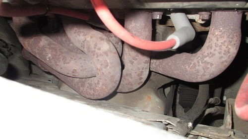

hey everyone i need help to identify these headers. Im wanting to do a gt40p head swap, and i want to know if these headers will fit. Thanks!
Don't even consider any other header than the FRPP shorties for P heads. I picked up a set with 500 miles on them for $150. The quality and fit are great along without burning my plug wires.I had headers that looked similar to that when I did my last GT40p swap, and they were not even close to fitting...Invest in some Ford Racing shorties
are the Frpp headers equal length?
