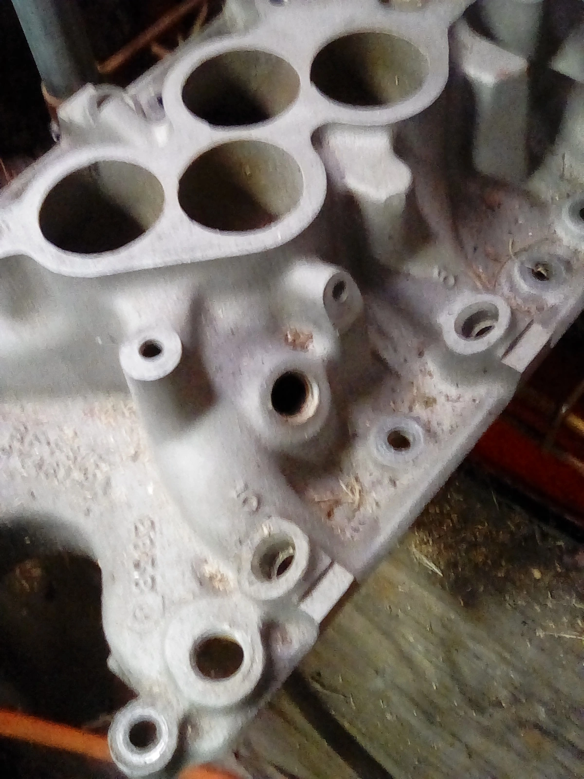

OK, I checked and there is a sensor in that location. It does make me wonder what sensor could go in the plug right next to the engine coolant temp sensor.

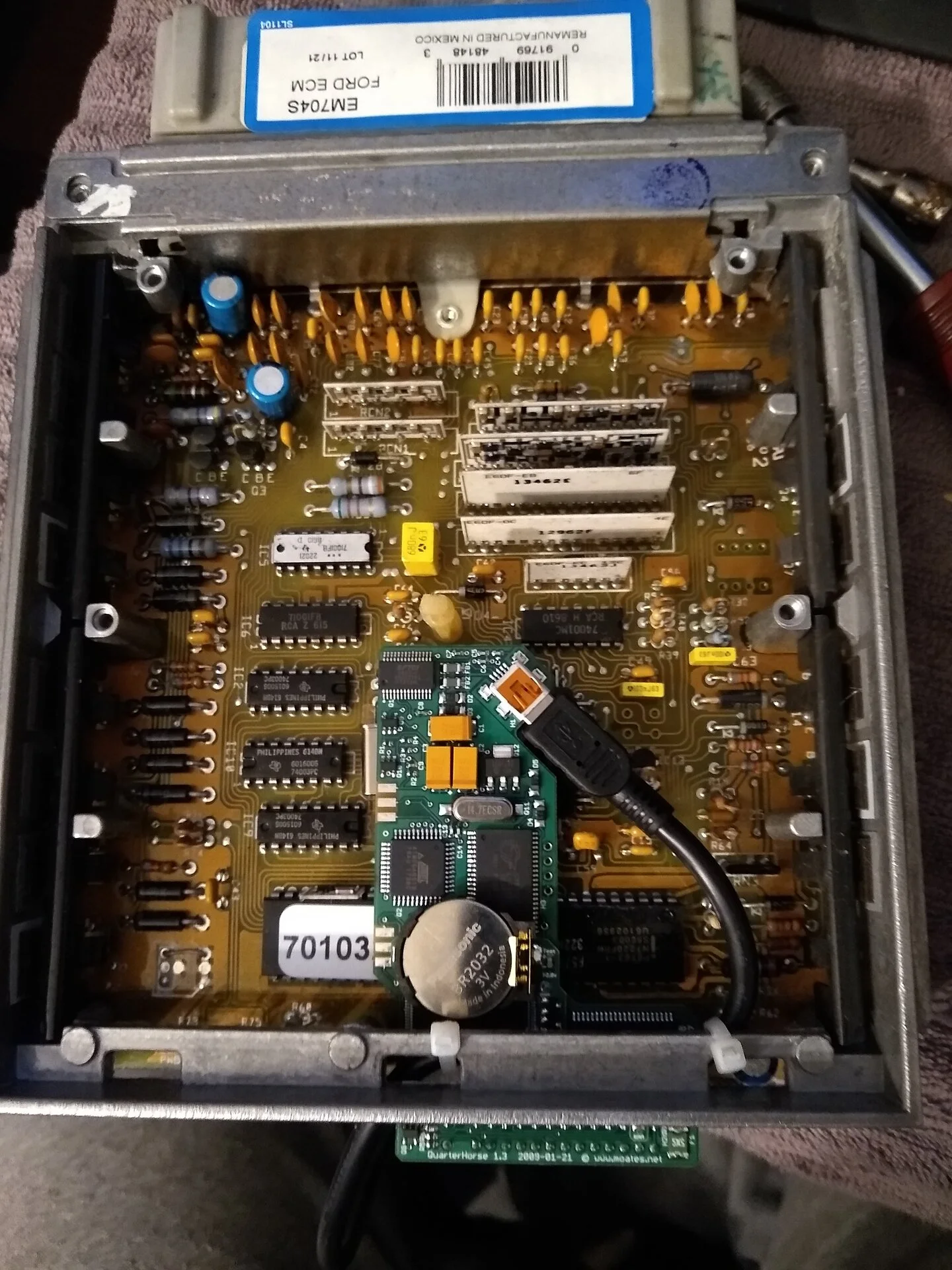

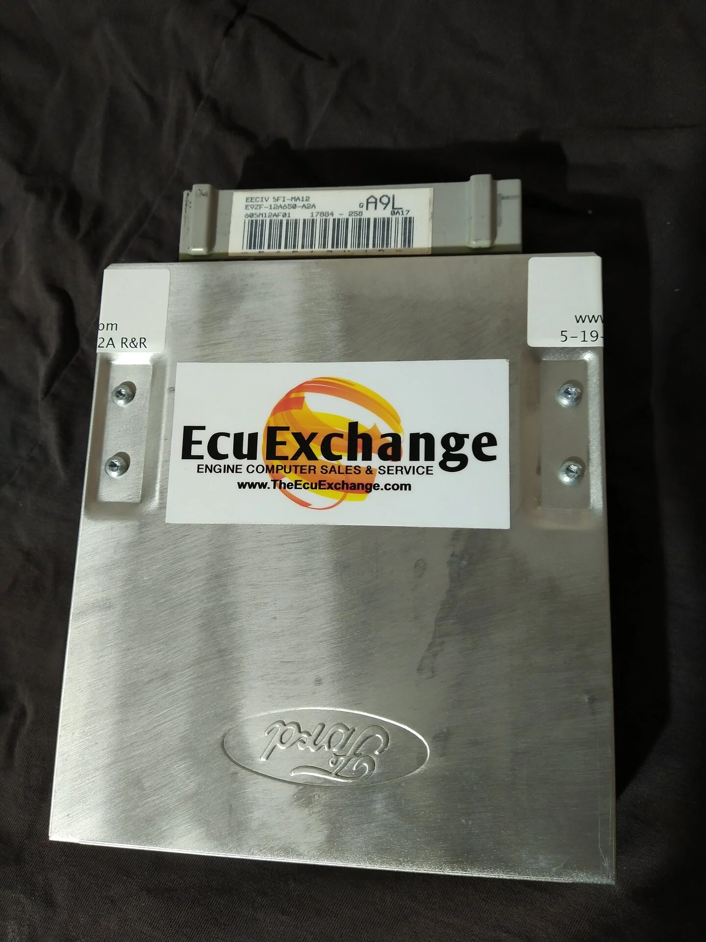

I saw codes for a 2.3 engine and your dads car is a V8 which means to me that the ECU maybe your culprit as I found out that BlueStreak uses 2.3 computers and turns them into ones that will run a V8...I had so many problems too ...
So many problems I finally broke down and bought an actual A9L from Ebay then I sent it direct to ECU exchange to be diagnosed and beefed up..In the end I spent $600.00 for peace of mind...
Im glad I did as the guy told me the fuel pump circuit was toast and some injector caps were blown...........He also said the computer was heavily bombarded by flyback..

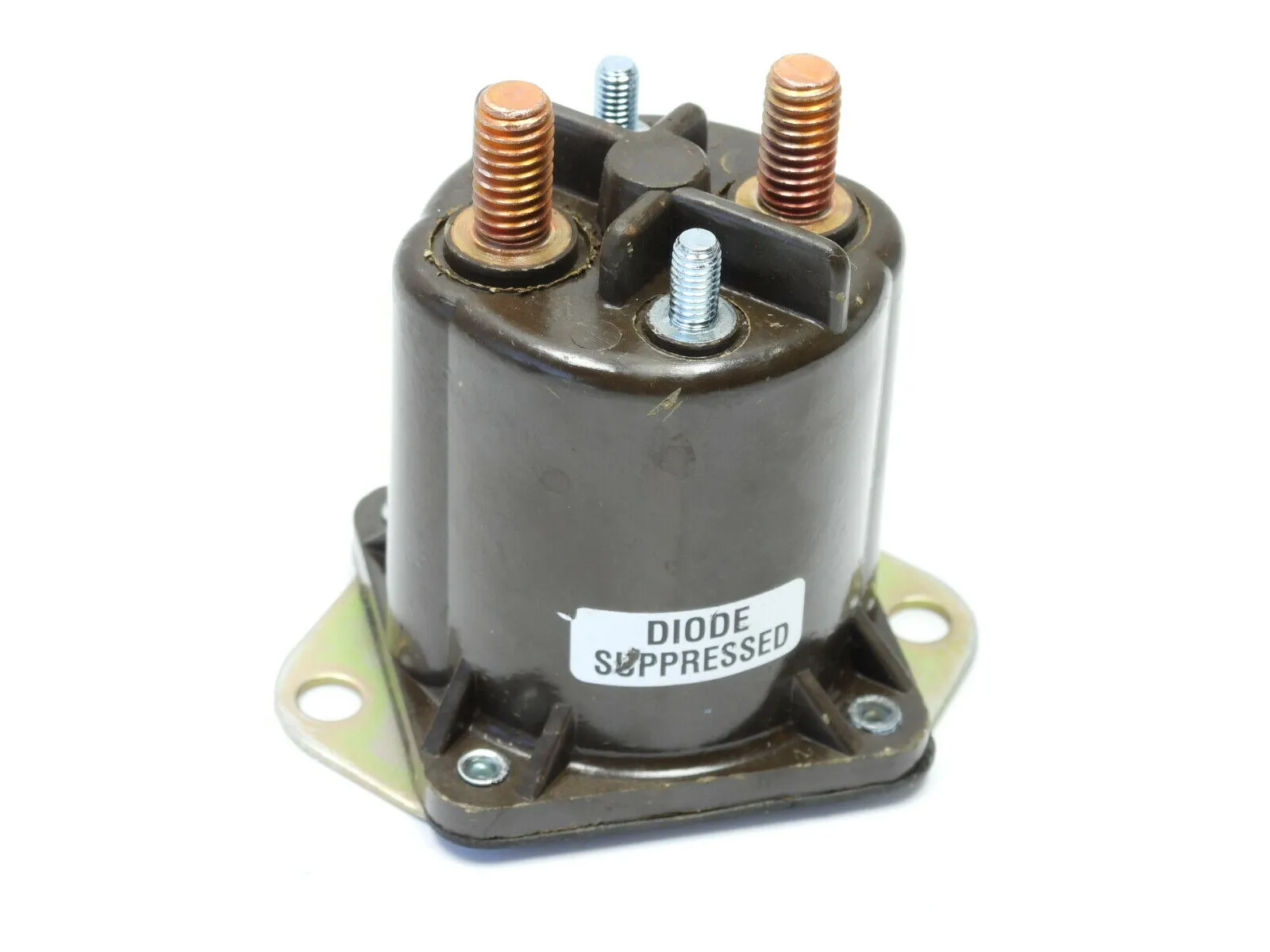

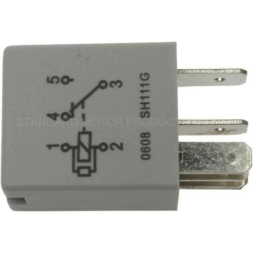

For the flyback issues I put a diode protected starter solenoid and I also put diode protected relays for the fuelpump and the EEC...............
First pic is the ECU I bought and then had refurbed. Second pic is of a diode protected starter solenoid and Third pic is of a diode protected relay....They started putting diode protection on the EEC and fuelpump relays starting in 1995..........
Last picture is of the Blue Streak Computer I had issues with....Even though it was burnt as an A9L it wouldnt work with my tuning chip...............

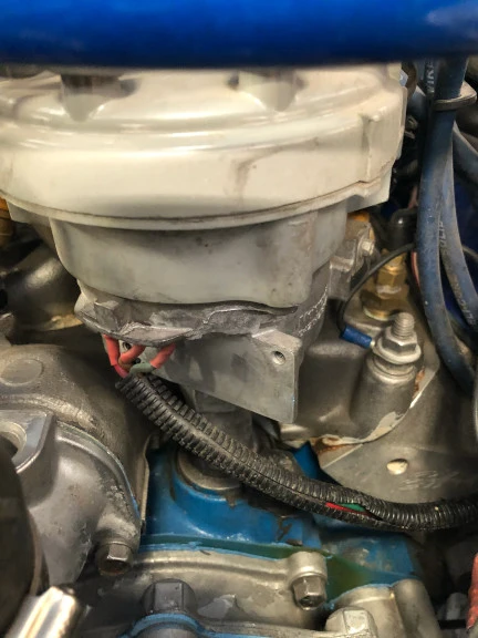

I may have found something. I was checking for loose connections in the areas I was testing at the beginning, when the fuel tank install didn't work. I found one of the three wires on the distributor that my Dad or one of his helpers made when they relocated the electronic module to the driver's side fender was loose. That made me recall that it had come off, back at the start and I just reached in a plugged it back in by feel. Well, today I pulled it loose and found it was really easy to plug the small male solderless connector in to the wrong place. it was real easy to stick it into the gap between the brown insulator and the distributor case and not where it should go. I had to use a mirror and a flashlight and it took multiple tries to get the little spade go into the female connector in the distributor. I had the engine warming up, prior to this, to run the diags again, so I can't say for sure it made an big change, since the big symptoms happened when it was cold. It did fire up and let me rev it, when it was plugged in, I'm going to see if I can come up with a better way to plug into the bottom of the distributor. Something where all three get plugged in together and stay spaced apart and snug.
I'm hopeful about this, since it ran better before I started wire tracing way back when. I'll look up what the far left of the three pin, as looking at the distributor from the front does and see if it would cause my issues.
