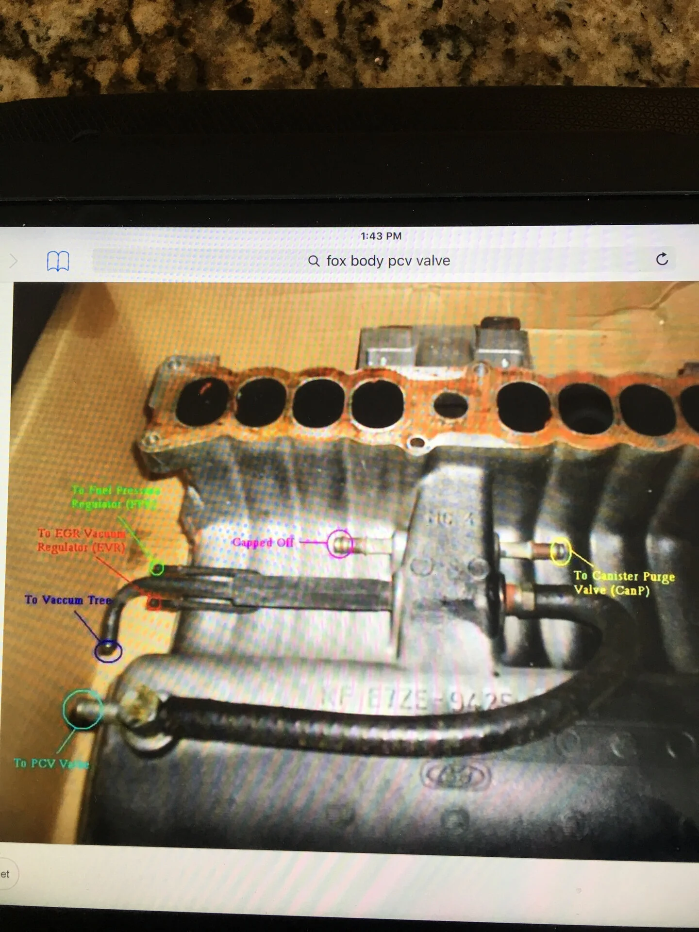

There doesn't look to be many vacuum lines to be honest. One from the passenger valve cover to the throttle body is one I know of and I made a new hose for that.

Technically, the line from the oil fill tube to the throttle body isn’t a vacuum line, but an emissions hose to route oil vapor into the intake manifold. That shouldn’t affect running behavior. I’ll attach a picture showing the vacuum lines.

I'll crawl over the back of the intake and see if I knocked anything loose tracing the wires. I should find the hoses coming out the back connected to something. I don't think I touched any of that, but strange things can happen.
I haven't pulled the intake, but I've determined, by feel and flashlight that I only have the large line to a power brake booster and a small line to the Fuel Pressure Regulator. The large hose at the front looks in good condition and moving it as much as I can does not change the idle. Doing the same at the back where the lines come out also has no affect. I starting messing with the MAF sensor and air filter. Removing the air filter didn't change much. Then I pulled the connector to the MAF sensor and nothing really changed. I cleaned it with contact cleaner with no improvement. I cleaned the MAF with special MAF cleaner, during the earlier I then pulled the MAF connector and it didn't change that I could tell. It makes me wonder if that is at least part of the issue.
