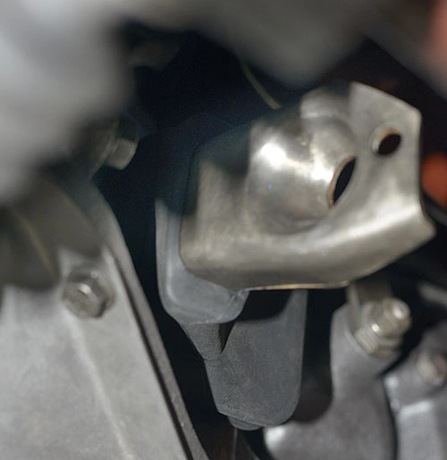

Not sure what "type" it is, but it is on a 390 engine. I have attached (hopefully) images of the clutch fork (looking at the forward side of it), and of the parts that were sent to me. If that helps at all. Sounds like I should have a couple more nuts (resisting temptation to insert something clever here...) and a washer.
been a while since i worked on a big block with 4 speed ,it looks like the bushing may go in the arm with the pivot ball riding on that does the bushing have a lip at the small end? it looks like it locks in the arm , the two nuts must go before the pivot ball
with one as a jamb nut, couldnt imagine that bushing lasting long if thats the way it goes, must be like an anti rattle bushing
