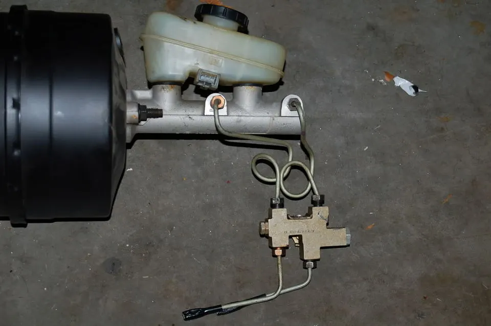

Here's a picture of the new stuff that I can use...

Your diagram will work. If you already have the parts, then do it. I also used the summit line lock, but did not use the 3-2 conversion piece. I made my own lines, one from the master cylinder to the line lock, then used to exit ports from the line lock to go out to both front brakes. But like I said, if you already have the pieces, use them. It is easier than making your own.
Joe
Stock with your factory Fox prop valve. Just gut it (and install adjustable PV on firewall) and then use the MM 3-2 conversion to use it with your 94-95 Cobra MC.
The SN95 prop valves have different size fittings out to the chassis, so unless you feel like like cutting and reflaring the body lines out to the front pass brake and rear brakes, it's easiest to stick with the stock Fox PV
