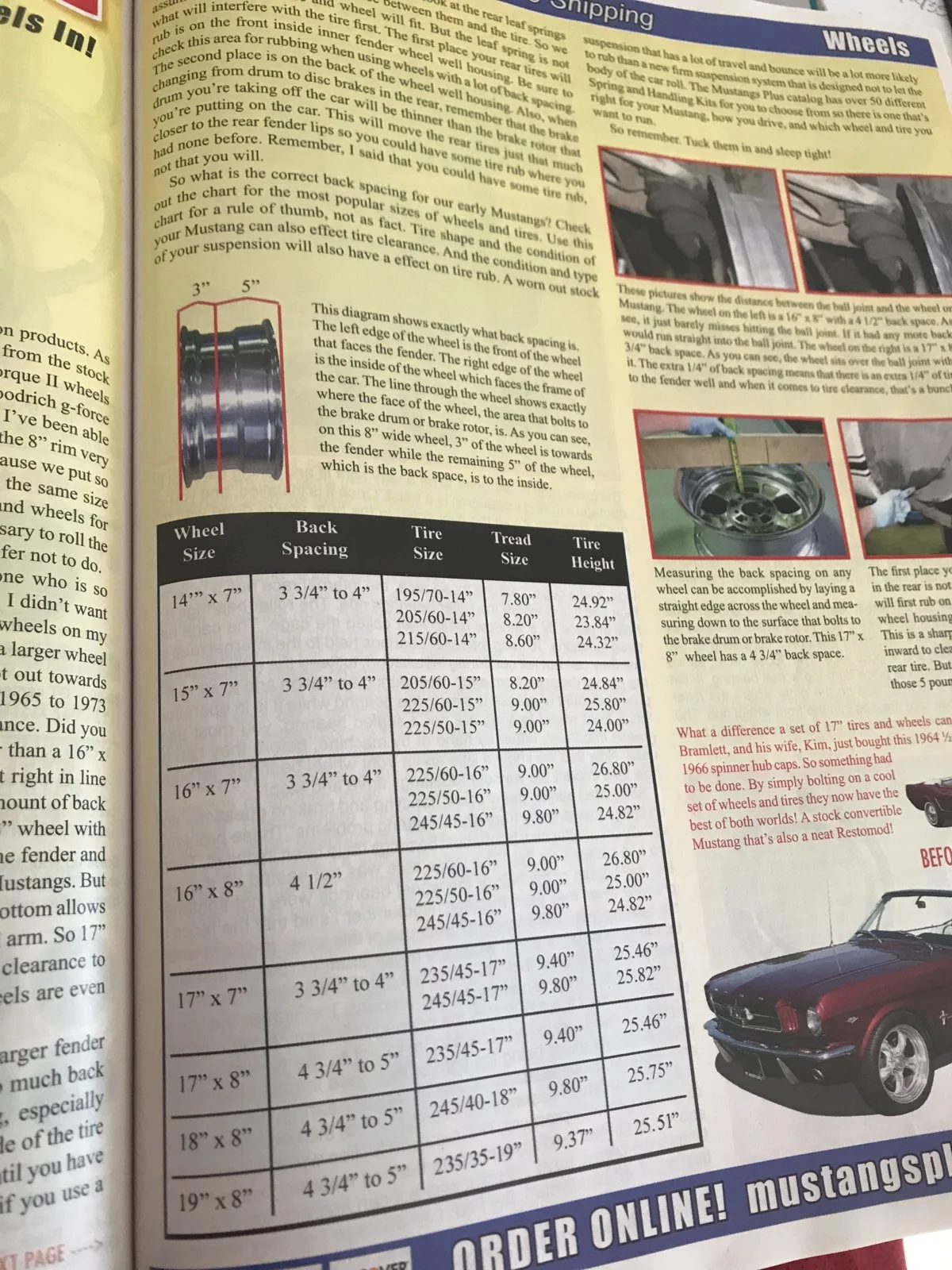

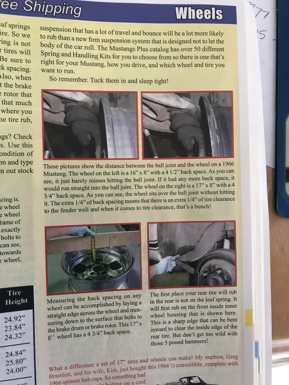

Need help with get some torq thrust rims for my 1965 Ford Mustang
I know I want 16x8s but don’t know backspacing measurements I need or offsets
You cant just say a number and expect it to fit universally. How the quarter was repaired, the rear end in it, are you willing to roll lips, and how worn-out the suspension is, all affect what can and cannot fit.
Mustangs Plus used to have a discussion (article) on this topic that could help you.
But I ve been having a hard time with the website.
