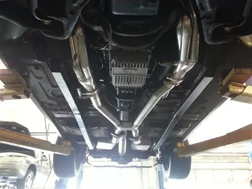

This picture is from latemodel restoration. Description says BBK, and that looks like an auto trans to me........
