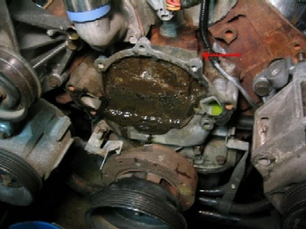

Are you sure about that? There is a gasket between the plate and the block. I attached a picture and you can see where the gasket is. And where I put the arrow is where it is leaking. So I need to get that whole piece off.

the plate you are talking about is the timing chain cover. There is no water passage between it and the block, just oil. Your leak must be coming from some place else. and fyi yes you need to pull the harmonic balancer to get that cover off.
Really? So maybe the leak is coming from between the water pump and the plate. That would mean that I do not have to hassle with taking off the plate.

Could be what was just said, the weep hole on the bottom of the water pump, some of the heater hoses, or the backing plate of the water pump's impeller which just went on mine. It's a busy place up in there so you need to look carefully as it is quite a few things it could be.
I am being told at another site that even though water does not flow through the back, it could still leak through that area if the gasket is bad. What do you think? Should I do it since I almost have it all off?
Water passes through the timing cover to the block. So it is possible to have coolant leaking from behind the cover. However from where you have you arrow pointing it doesn't look like it would be that.
