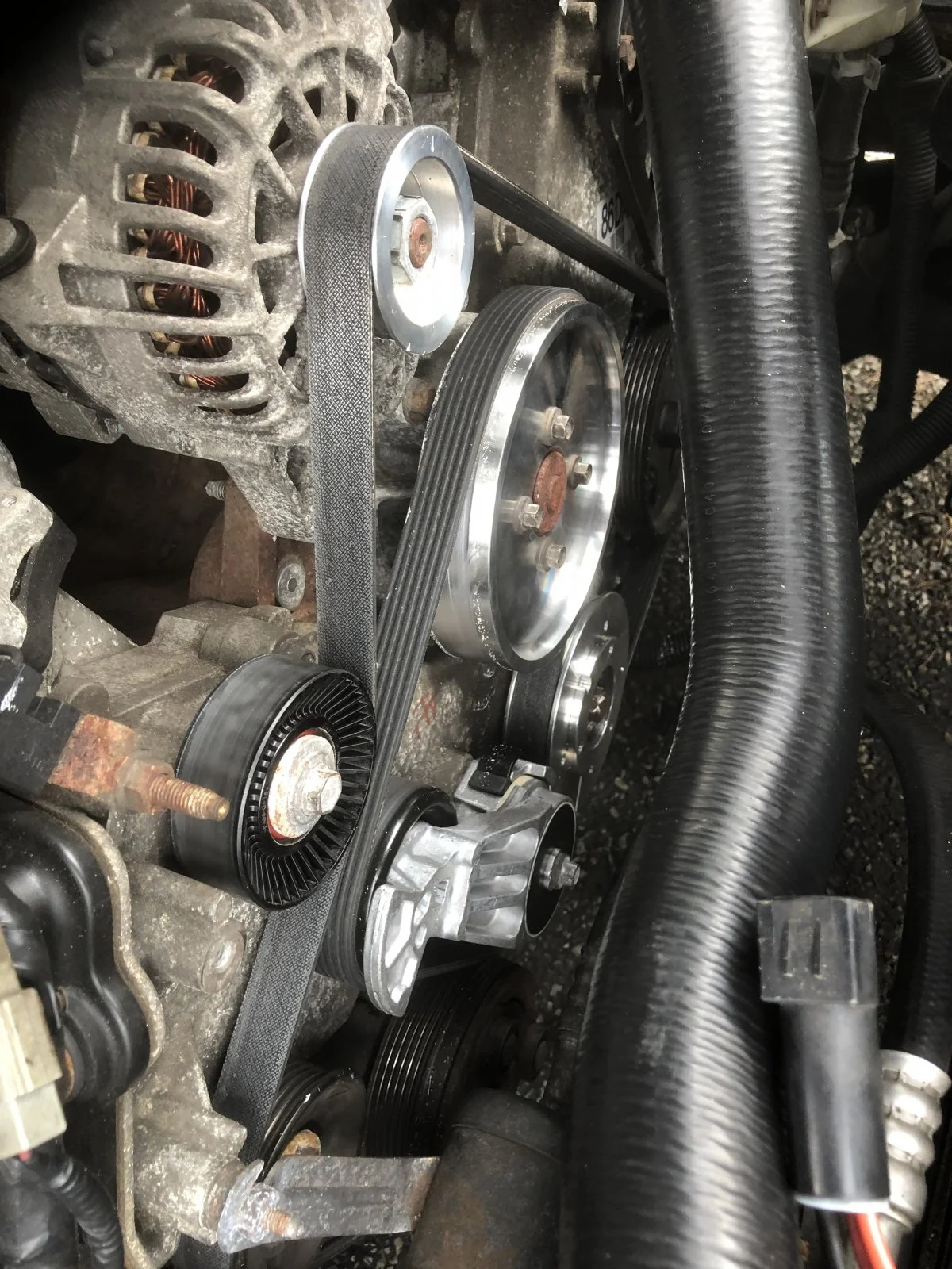

So I have a 03 GT. When I bought the car an SR performance underdrive kit came with it. Now while doing the pulleys I get to putting on the crank pulley. Instructions/pictures that came with it said to attach my old balancer and pulley to the new SR pulley. Is this correct? Or do I just leave the SR pulley by itself?

Yes...it's called a "piggy-back" style underdrive. Not a big fan of them.
The 4.6 modular motor depends upon a stable CKP signal. The piggy back style UD pulleys are some of the more likely to cause an unstable CKP signal. If you are going to go this route spend the $$ and get a high quality unit. You'll thank us in the end.

Noticed a little difference. It looks nice and all but in all honesty go with a steeda. They come with the balancer already attached. I still have my sr performance one on though. The picture is before I put the balancer on.
