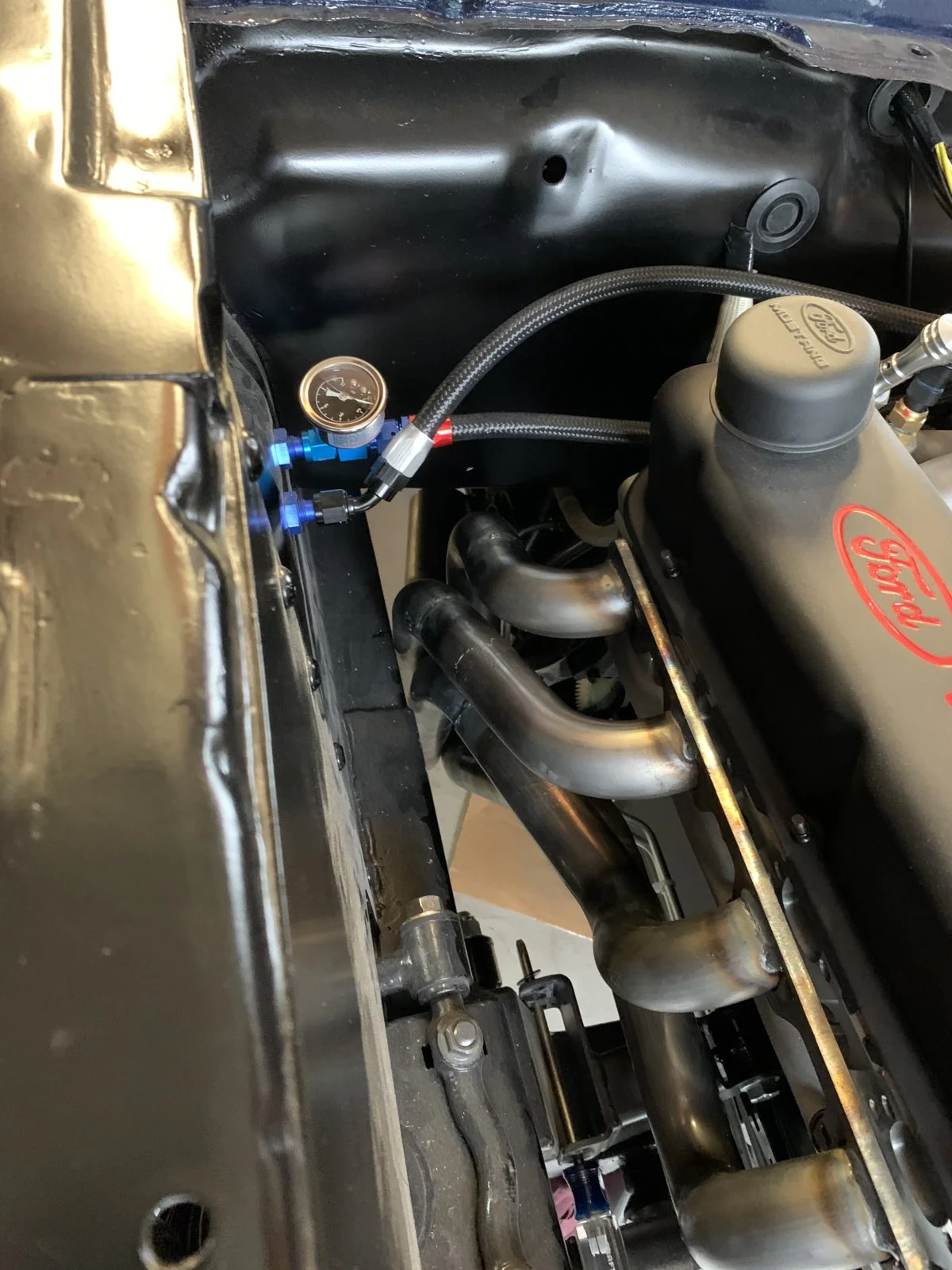

I have experience with Flowtech, hooker long tubes on 5.0/302 with a C4. They both work. The "large" bellhousing isn't any bigger than the "small" bellhousing; however it is shaped slightly different and that can cause some issues occasionally. I have always run "small" (157t) bellhousings only because I had a stock pile of C4's and 157t bellhousings to fit them at one point. Switched to powerglide at a later date, ditched the C4's and never looked back (bracket racing Mustang, then a Fairmont, now a '85 LX coupe). Flowtechs DO fit with the small c4 but are really tight with the powerglide. Hooker's fit ok as well with the C4. Never tried RCI, Kooks, or any other brand as I never needed to. Did a 414" in the '85 LX coupe for a little while and used Hooker swap headers with it; they work fine but it is nothing more than a race car that doesn't have any exhaust on it; and the collectors point RIGHT at the crossmember. I stuck a 302 back in it and used Hooker 1 3/4" long tubes on it, then stuck the 351w headers in my '92 GT 427"w. Same issue but had to dogleg the H pipe to clear; and that's just barely clearing. Everything else fits pretty good around the shaft and the T56 magnum and the starter (using 8031 bellhousing) and a stock type 93 Mustang starter. Big starter won't work. neither would my old CVR starter but that's ok cause the stock starter is cheaper and easier to find when it does die.

thanks all, I am sending BBK 1516s back and using my 87 Blackjacks again.
