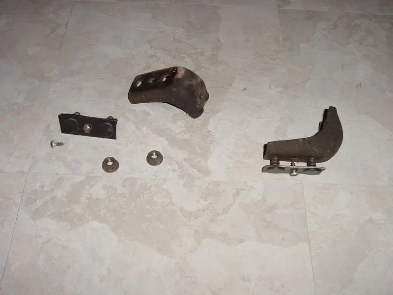

Not sure how close to original you were looking for, but here is a pic of my old brackets. They actually have 3/8" studs and are held in place with a small screw. I'm sure 5/16 would be fine.
As a side note, Ford also strengthened the floor pan with another formed layer of sheet metal where the above brackets get attached. The added sheet metal was installed on the inside of the car (vs the underside.)

Tim65GT, 3/8? Ok might as well do it right. Not going concours (I plan on a Magnaflow system) though will weld them in through a reinforcing sheet from the inside as Dennis mentioned.
