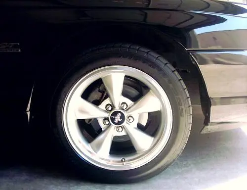

I just put mine on after them sitting in the garage for like a year. I just have a 3.73 and exhaust. These brakes are worth their weight in gold. Anyone who complanes about the weight they add should be shot. The stock brakes always fade.
The other day on the way back from the track I left it in fifth and took it to about 125. Now the highway was wide open so it was no problem. But we saw a cop with its lights on up ahead. So I stood on the brakes and was chirping the abs at everything under the 100mph mark. The brakes are great. And defintately upgrade to the stainless braided lines. I just got mine in from partshopper and they are sweet. The pedal feel is exelent. Only about a 1/8 to 1/4 inch of pedal effort is necessary to easliy slow the car.
Plus they look awsome.

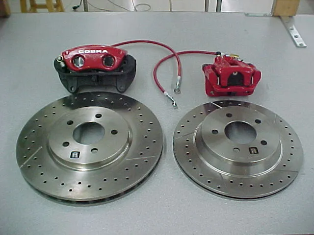

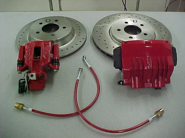

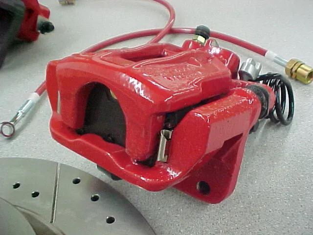

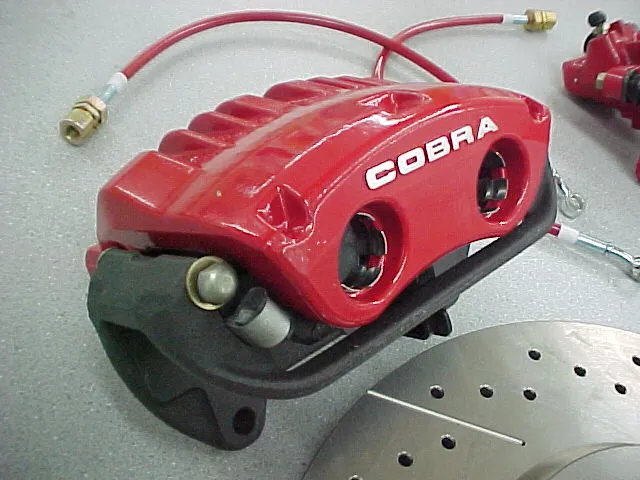

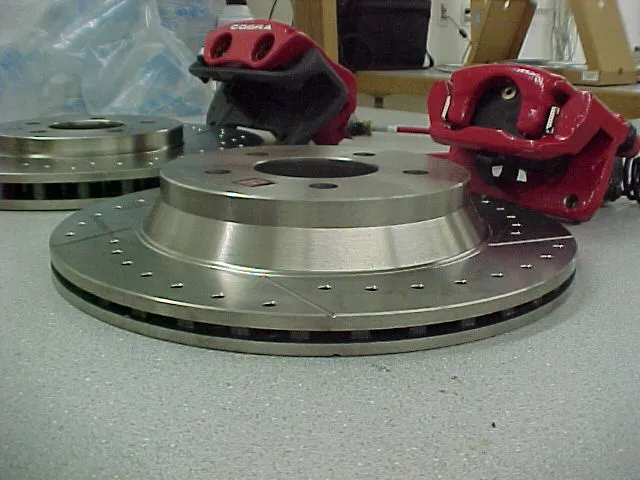

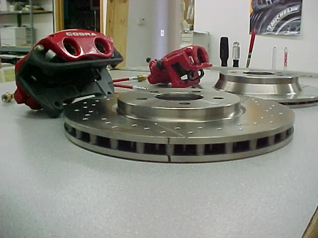

I picked up all four corners with 10th anv. cobra brakes, drilled/slotted rotors, and stainless lines last thursday. Should be comming in today or tomorrow. Maybe I can snap a pic when they come in
