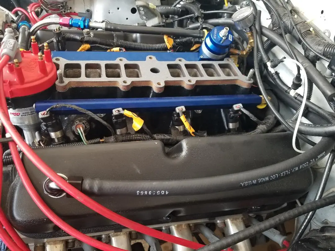

Seems to have cleared after replacing the capacitors. New problem is a metallic noise coming from the passenger side. It's not quite knocking, not quite pinging, but definitely metallic. Problem is that the manifold on that side goes directly into the turbo. We're pulling the intake and valve cover to see what we can find, but I'm just hoping it is not internal.

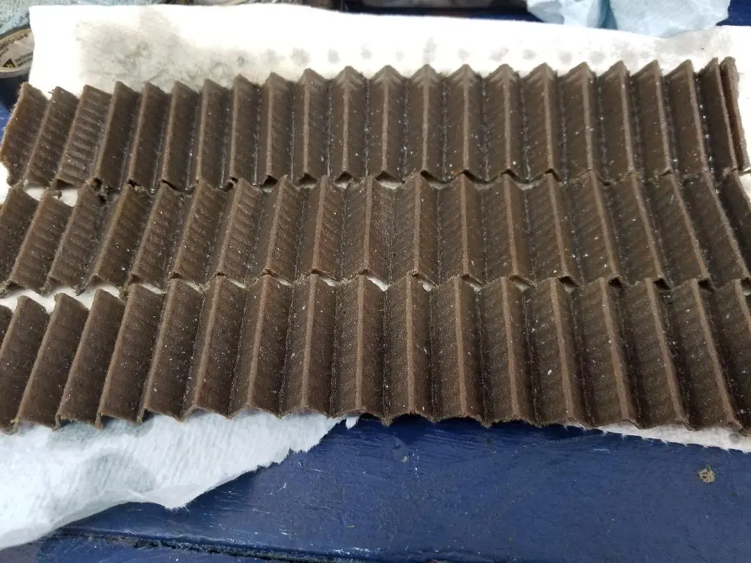

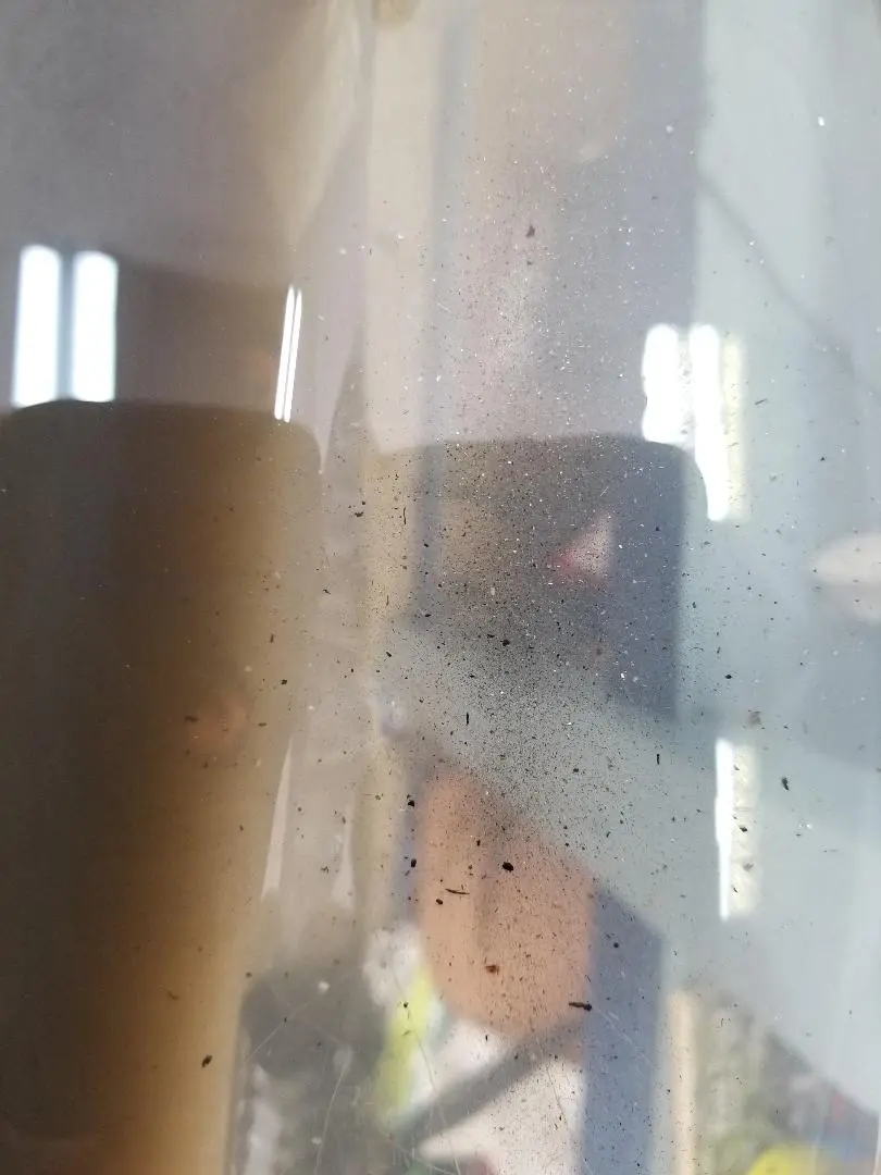

I've pulled the oil filter and found what I think is a ton of glitter. Now, I've had fuel in the oil, so it just makes sense that the viscosity would break down and cause excessive wear on the mains. However, I've never pulled apart a filter on break in and have several folks telling me to drop the oil, refill, and carry on. Anyone with experience reading filters?
filter element
