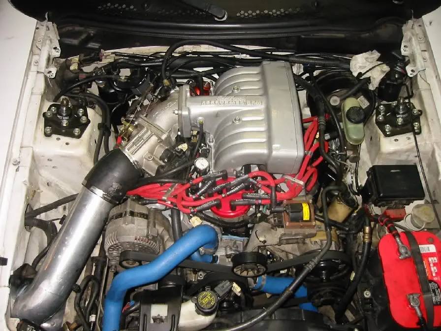

Some pics on the car.
I just got mine in yesterday and went to put it on and the elbow was waaay too big for my throttle body. Did you have this problem? What size throttle body do you have? Mine is a 65mm
Yeah the coupler is huge you can see that in my pic too. In that pic i have a 75mm tbody but before that i had a 65mm with it also. You just have to keep tightening that thing down and eventually it will grip. That couple is just huge. And no one even makes anything bigger than a 75mm throttle body for the 94-95s so i dont know why they make it that huge. Its even big on my 75mm throttle body.

I used to have a MAC intake before the anderson. I kept that piece and then cut the hole big enough to fit the anderson. The rubber part also came with the MAC intake.
