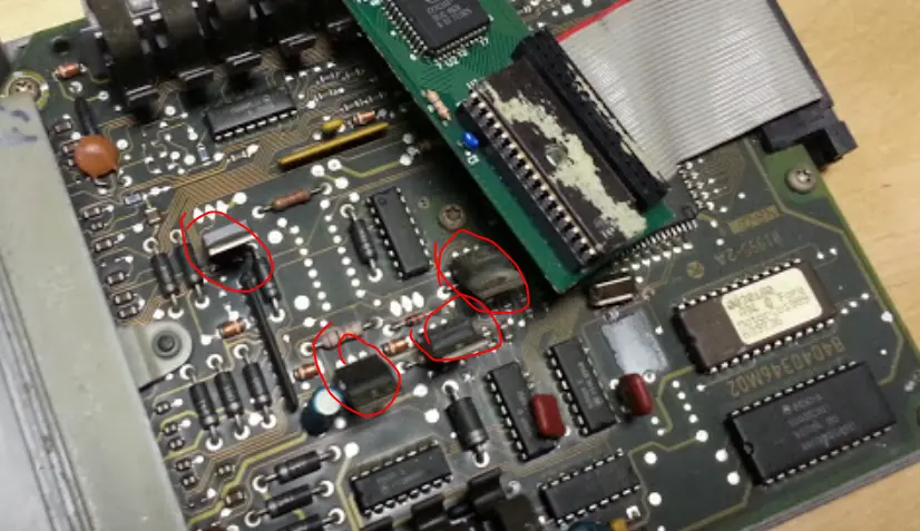

Internal power supply (for the 5v) is another weak part of the ECU. If the caps blow, they can’t protect it from surges and it can fry.
also don’t overlook a burned PIN 46 trace which is quite common as well.
Voltage regulator is what I meant to say.
Left pin is input (12V) center is ground and the right pin should be 5V output. I haven't peeked inside an A9L in a while but from this stolen pic it looks like there may be 4 of them. Would need to see the writing on them to pull specs.
Is that Diablo's 4-bank chip?
And yeah... That is [the] worst ECU I have ever seen in all my years. :rlaugh:
Put a Stangnet sticker on it and frame it! LoL

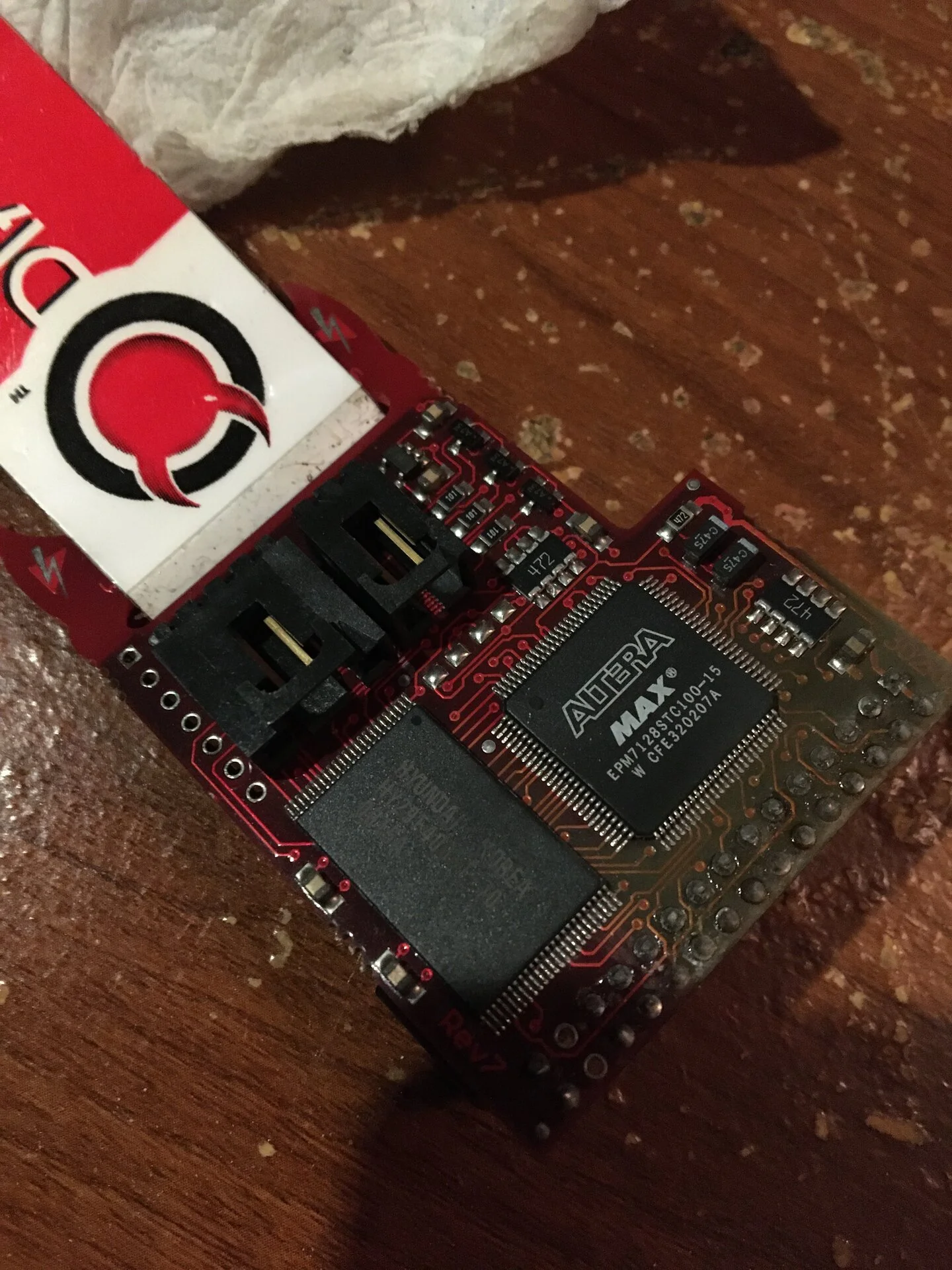

I'm not sure what chip but I do know I went to Diablo Motorsports and the tuner was Scott Beers. Very cool guy very heavy Canadian accent. I was a last minute customer and showed up without a blank chip luckily he had this one and spent about a hour on my car before it started getting outta my price range. He couldn't get my ECU back easily and didn't want to break any wires so we left it on the floor board and I never fixed it. My car sat for years cause I made some dumb mistakes and when I finally got back to it the ECU looked like a coral reef. I think I'm going to just get the Micro Squirt and try to use the auto tune feature. I also heard the Micro Squirt can tune with an AFR gauge and i can ditch my mass air.

reading through the comments on this one item I noticed wasn't brought up which is the fact the Diablo chip has to be plugged into J3 Port. This port is notorious for giving issues as well with connectivity to the chip. I used to run a Moates Chip years ago before going Megasquirt chasing my tail with issues of the car just to come find out it was the chip. So even if you do get a good ECU this still may become an issue.

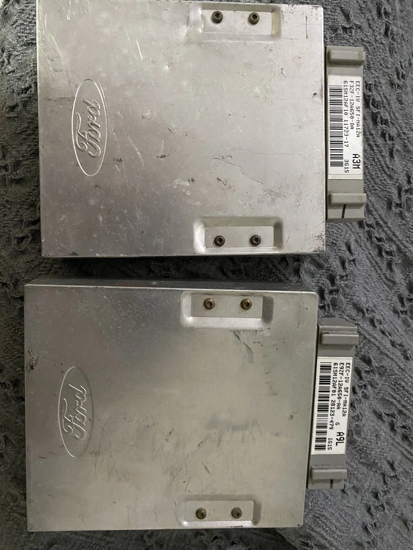

Is there any major difference from the A3M to A9L?
I ran both of these in my 1993 I sold, but kept these as spares for the current 1993
5 degree temp difference in A/C max engage. (247 vs 242) but that’s about it. Some minor hardware changes. I believe the A3M has a better internal heat sink.
consider them equal
